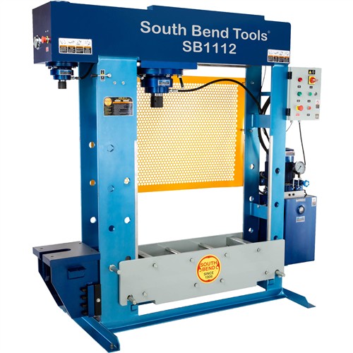

SB1112 Dual-Station HC-60T/24T Hydraulic Press
Industrial-size power and versatility for your pressing needs.
If you’re in industrial manufacturing, you know how important a high-quality, high-powered hydraulic press is for your operation.
The SB1112 Dual-Station Hydraulic Press delivers 60 tons of power at the H-frame main station and 24 tons at the C-frame side station.
This ability to have multiple setups can open new possibilities for your operation–with the dependability and precision craftsmanship of the South Bend name backing it up.
The Dual-Station HC-60T/24T Hydraulic Press is perfect for pressing gears on and off shafts, transfer molding, packing and compressing, straightening, punching, metal forming, and much more.
Your business is worth it–invest in the best!
GENERAL SPECIFICATIONS:
  • Required power supply: 220V, 3-phase, min. 20A circuit
  • Hydraulic motor: 5-1/3 HP, 220V, 3-phase, 15.2A
  • Footprint: 35-1/2" x 63"
  • Overall dimensions: 83" W x 35-1/2" D x 82" H
  • Approximate shipping weight: 3241 lbs.
H-FRAME MAIN STATION RAM:
  • Max. applied force: 60 tons
  • Max. stroke: 11-13/16"
  • Ram diameter: 3-1/8"
  • Max. distance to table: 36"
  • Min. distance to table: 6-7/8"
  • Max. workpiece width: 39-3/8"
  • Number of bed adjustment positions: 4
  • Bed adjustment hole spacing: 9-13/16"
C-FRAME SIDE STATION RAM:
  • Max. applied force: 24 tons
  • Max. stroke: 9-13/16"
  • Ram diameter: 2"
  • Max. distance to table: 39-9/16"
  • Min. distance to table: 10-1/16"
  • Two workstations
  • Welded steel frame
  • Sliding head press for off-center workpieces on H-frame main station
  • Motor-driven hydraulic operation
  • Built-in pressure gauge
  • Protective rear shielding
  • Four table height positions for main and side presses
  • US-based customer service and technical support
