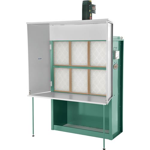

Finally an affordable means for spraying finishes in your shop. Heavy-duty construction throughout means years of trouble free service. Requires ducting to outside air, after which with proper use, will remove overspray, keeping your shop cleaner and safer while improving the finish on your projects. Other features include: 12" aluminum impeller; 12 15-1/2"W x 19-1/2"H x 1-3/4"D first and second stage filters; 6 15-1/2W x 15-1/2H x 1-3/4"D third stage filters; approximate shipping weight is 543 lbs. Please be sure to check with local, state and federal regulations that may govern the use of spray booths in your location prior to placing an order.
  • Motor: 3 HP Baldor®, 230V, single-phase, 15 amps, 1725 RPM, explosion proof
  • Filter system: 3-stage, 30–10–5 microns
  • Air capacity: 1900 CFM
  • Outlet size: 12"
  • Impeller: 12" Aluminum
  • First & second stage filter size: 15-1/2" W x 19-1/2" H x 1-3/4" D
  • Third stage filter size: 15-1/2" W x 15-1/2" H x 1-3/4" D
  • Number of filters: 18
  • Working area: 51" W x 51" H x 22" D
  • Overall dimensions: 63" W x 100" H x 52" D
  • Approximate shipping weight: 543 lbs.
