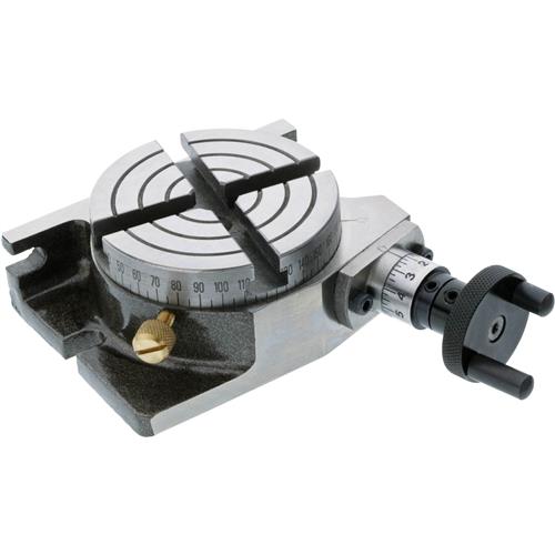

H6195 3" Rotary Table with Indexing
This remarkable 3" rotary table is priced affordably, too!
A great rotary table for all you model makers and those doing smaller, precision work.
A rotary table allows drilling or cutting at exact intervals around vertical and horizontal axes.
The H6195 3" Rotary Table can be used in the horizontal or vertical position for a variety of milling applications.
These different operations include milling eccentric features, cutting arcs, create large diameter holes, and circular profiles.
Control is very accurate and precise thanks to the 10° table movement per handle rotation and 15 minute vernier scale.
Like all Grizzly rotary tables, the H6195 comes with a 1-year warranty which covers parts and assures the unit is free from factory defects.
The Grizzly Customer Service and Technical Support Teams are U.S. based. Parts for the rotary table may be available online and shipped from the Grizzly parts warehouse in Springfield, MO.
  • Size: 3"
  • Total T-slots: 4
  • T-Slot size: 5/16"
  • Table height in horizontal position: 1-5/8"
  • Table height in vertical position: 3-1/4"
  • Approximate weight: 5 lbs.
  • Can be used in horizontal or vertical position
  • 10° per Revolution
  • Vernier scale reads to 15 minutes
  • Brass lock knob
