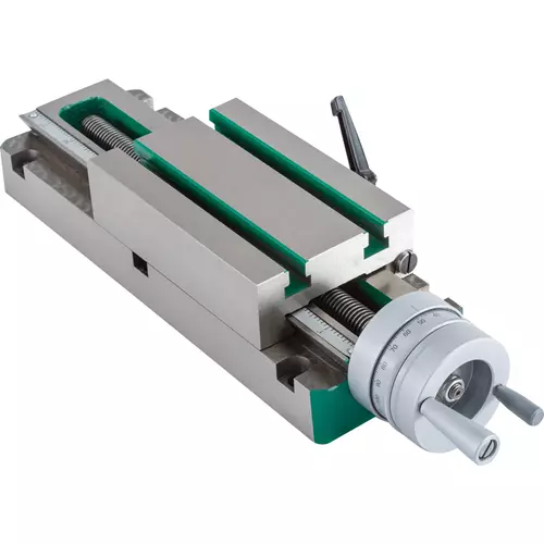

T31762 4" Horizontal Slide Table
A stout and precise sliding table for cross slides of metal lathes during milling operations.
You can secure parts to the T31762 4" Horizontal Slide Table for cutting keyways and other milling operations.
The table features heavy-duty construction including two 5/16" T-Slots for locking down your workpieces.
The table measures 3-15/16" x 5-7/8" and has 6-1/2" of horizontal travel.
The dial has fine graduation of 0.0005" for precision milling and drilling.
The T31762 comes with a 1-year warranty covering parts and assuring the unit is free from factory defects.
Parts and accessories for Grizzly products are available online and shipped from the Grizzly parts warehouse in Springfield, MO.
  • Lead screw: 10 TPI
  • Graduations: 0.0005"
  • Table size: 3-15/16" x 5-7/8"
  • Horizontal travel: 6-1/2"
  • T-Slot size: 5/16"
  • Mounting bolt hole: 6 @ 0.370 dia.
  • Footprint: 3-15/16" x 11-7/8"
  • Overall length: 15-5/8"
  • Weight: 18 lbs.
  • Fine graduations (0.0005")
  • Backlash is adjustable
  • Table lock
  • Quick reference inch scale with 1/8" divisions
