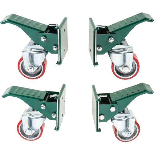

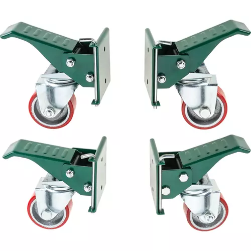

T32334 Four-Piece 400 Pound Total Capacity Workbench Caster Set
The best set of heavy-duty casters for your shop equipment.
Mount these heavy-duty, 3" workbench casters to your wood workbench and you’ll instantly have a mobile workstation!
As a set, the four casters will support up to 400 pounds; weight capacity is 100 pounds for each caster.
The casters feature quick-release toe flip levers to engage and disengage the wheels, similar to many of our machines that have built-in mobile bases—securing your workbench in position is a simple as stepping on the levers.
The premium polyurethane wheels swivel 360° for easy positioning and smooth movement across your floor.
The unique dual-option mounting system allows for direct mounting to the workbench legs or mount with the quick-release mounting plates for easy caster removal after your workbench is moved into place.
Designed for use with wooden legs only.
Like all Grizzly casters, the T32334 comes with a 1-year warranty which assures the set is free from factory defects.
Parts for the casters may be available online and shipped from the Grizzly parts warehouse in Springfield, MO.
400 lb. Capacity!
  • Caster diameter: 3"
  • Weight capacity: 100 lbs.
  • Lift height: 1/2"
  • Bottom of caster to top of mount: 5" wheel up, 7" wheel down
  • Bottom of plate to the wheel bottom: 1-1/8" wheel up, 3-1/8" wheel down
  • Square plate dimensions: 2-3/8" x 3-7/8"
  • Mount hole size: 1/4"
  • Holes center-to-center: 2"
  • Toe-flip levers for engaging and disengaging wheels
  • 360° Swiveling, premium polyurethane wheels
  • Quick-release mounting plates allow you to easily remove and re-install casters when necessary
