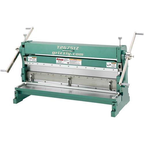

Our Z-Series models are specially built with heavier components and machined to closer tolerances to satisfy the increased precision and durability needs of the most demanding users. This no-compromise, 42" capacity Sheet Metal Machine is all you need to shear, brake and slip roll up to 20-gauge mild steel. Get the flexibility and capacity you need without spending a ton for separate pieces of equipment scattered all over your shop. This machine does it all!
- Maximum capacity mild steel: 20-gauge at full width
- Maximum width: 42"
- Minimum reverse bend: 1/2"
- Maximum height pan/box brake sides: 1-3/4"
- Number of fingers: 8
- Width of fingers: 1", 1-1/2", 2", 2-1/2", 4", 6", 10", and 15"
- Slip roll minimum diameter: 1-3/4"
- Footprint: 45-1/4" L x 20-1/8" W
- Overall size: 57" W x 29" D x 28" H
- Approximate shipping weight: 730 lbs.
