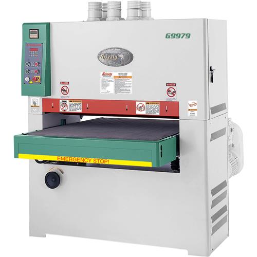

Image for Grizzly G9979 - 43" 25 HP 3-Phase Wide-Belt Sander
When your sanding needs fall under the category of production level, look no further than Grizzly for your wide belt sander. Manufactured for the industrial user, this machine features state-of-the-art electronics, precisely engineered components & innovative design & construction. Whether you need to sand a silky smooth finish on a highly figured tabletop, dimension rough lumber or simply run panels all day long, these sanders will make light work of the toughest jobs.
CSA certified meeting CAN/CSA C22.2 #71.2-08 and UL 987 standards!
  • Sanding belt motor: 25 HP
  • Voltage/Phase: 220V/440V*, 3-Phase, 64.9A/32.5A
  • Belt feed motor: 2 HP
  • Table elevation motor: 1/4 HP
  • Pressure roller type (double): Rubber
  • Infeed Drum: Spiral Grooved Rubber
  • Outfeed drum: Steel
  • Belt roller diameter (each): 4"
  • Platen: Micro Adjustable Graphite/Felt
  • Size of sanding belt: 43" x 60"
  • Maximum board dimensions: 43"W x 6"H
  • Minimum board length: 14"
  • Conveyor speeds: Variable, 15-60 FPM
  • Air requirement: 57 - 75 PSI, 7 CFM
  • Surface speed of drums: 2200 FPM
  • Approximate shipping weight: 2490 lbs.
Features:
  • Convenient control panel with separate switches for each motor
  • Amp meter load sensing system
  • Disc brake system for emergency stops
  • Variable feed speeds
  • Fast belt changes (takes less than 30 seconds!)
  • Pneumatic sanding belt oscillation control
  • Digital readout to within 0.005"
  • (5) 4" dust ports
*This machine is prewired for 220V. We can rewire to 440V in a few days’ time for a fee of $325. Please contact Grizzly Technical Support at (570) 546-9663 before placing your order.
