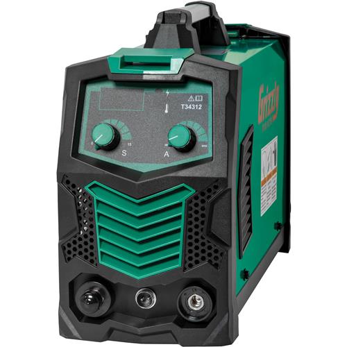

T34312 50A Plasma Cutter
Power through thick metal workpieces with this versatile dual-voltage plasma cutter.
This compact plasma cutter is perfect for DIYers, hobbyists, and fabricators looking for a portable machine that can easily cut steel up to 3/8" thick.
With dual voltage and adjustable amps, this portable plasma cutter works equally well at home and on-the-job.
The machine's high-frequency start makes it easy to execute precision welding with various material types.
Take advantage of additional features such as a digital AC display, an air and water separator, and a pressure regulator to complete metal fabrication, automotive repair, and specialty projects.
