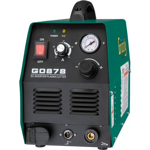

G0878 40A Plasma Cutter
Leave the cumbersome oxyacetylene cart behind!
The Grizzly G0878 40 Amp Plasma Cutter is a compact 25-pound unit with serious cutting power. When connected to standard 120V household power, it can quickly cut through steel up to 1/2" thick. For even greater capability, plug the cutter into 230V power and you'll be able to cut through steel up to 5/8" thick. Just attach the unit to your air compressor with the easy-to-attach 1/4" NPT fitting, and you're ready to go.
Tired of burning through cutoff wheels? The G0878 allows for straight-line or curved cuts in a matter of seconds. You cut in places where angle grinders can't reach.
The G0878 Plasma Cutter features a built-in pressure regulator that allows you to dial-in the air flow. When making low-amperage cuts, you can reduce blow back by kicking incoming pressure down or power-through thicker material with a maximum of 150 PSI.
Whether free handing the cut or using complex template to trace out your pattern, you have the power to cut through heavy gauge material including steel, stainless steel, aluminum, copper, brass and other conductive metals.
  • Input power: 120V/230V, single-phase, 20A/50A
  • Output current range: 20-40 Amps
  • Duty cycle (120V): 60% @ 30 Amps
  • Duty cycle (230V): 50% @ 40 Amps
  • Max. material thickness (120V): 1/2"
  • Max. material thickness (230V): 5/8"
  • Protection class: IP21s
  • Overall size: 8" W x 19" W x 12-1/2" H
  • Approximate shipping weight: 31 lbs.
  • High frequency start
  • Adjustable amperage setting
  • Built-in pressure regulator with gauge
  • Capable of cutting stainless steel, copper, iron, and aluminum
