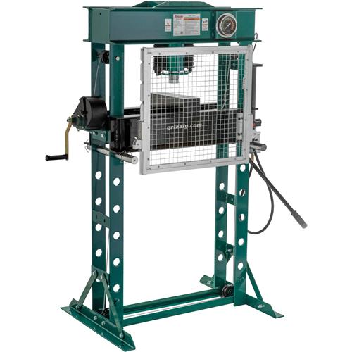

T34349 50-Ton Hydraulic Shop Press
An extreme force capacity industrial shop press designed for heavy fabrication and precision results.
This highly adaptable industrial hydraulic press offers sturdiness and reliability for processes including pressing, bending, broaching keyways, and even complex structural metalwork.
Tough arbor plates make it easy to switch between extreme force tasks, and the welded pump cylinder can easily handle the pressure. The hydraulic press offers both pneumatic and hand pump operation for versatility, and the force gauge ensures exact pressure readings.
The interchangeable ram end simplifies switching between processes, and a spring-assist on the return makes repeatable tasks a breeze. And to accommodate any workpiece size, the table is easy to adjust via the user-friendly winch and pulley system.
Safety isn't an afterthought with this heavy-duty shop press – it comes equipped with a protective screen to prevent accidents during operation.
This shop press is ready to exceed your expectations for metal fabrication, automotive repair, manufacturing, and machinery maintenance with 100,000 lbs. of ram maximum applied force.
FEATURES AND BENEFITS:
  • H-Frame Design: The sturdy welded steel H-frame shape offers maximum support and ensures accuracy during every press operation.
  • Two Heavy-Duty Arbor Plates: Created to withstand high-pressure applications, these steel plates can be used for multiple tasks.
  • Welded Pump Cylinder: Welded construction ensures durability, minimizing wear and tear and providing reliable performance even with repeated use.
  • Pneumatic and Hand-Pump Operation: Get direct control over the amount of force applied and a more regulated press cycle.
  • Liquid-Filled Force Gauge: Provides highly accurate pressure readings even in harsh conditions.
  • Interchangeable Ram End: Easily switch between different ram ends as needed based on material type.
  • Spring-Assist Ram Return: Automatically returns the ram to the starting point after each completed process.
  • Winch and Pulley System: Efficiently and safely raise and lower the worktable for precise adjustments.
  • Adjustable Table Height: Modify the table height as needed based on workpiece size for the most effective ram travel and pressure.
  • Safety Screen: A fully adjustable guard provides essential protection during high-force operations to prevent on-the-job injuries.
  • Ram max applied force: 100,000 lbs. (50 tons)
  • Ram maximum stroke: 7-1/2"
  • Ram piston diameter: 2.285"
  • Ram face diameter: 2"
  • Maximum distance to table: 33"
  • Minimum distance to table: 5-1/2"
  • Bed support pin diameter: 1-9/16"
  • Bed adjustment holes: 6
  • Bed adjustment hole spacing: 5-1/2" on center
  • Hydraulic fluid type: Standard hydraulic jack oil
  • Footprint: 39-1/2" x 29-1/2"
  • Overall dimensions: 51" W x 41" D x 66" H
  • Approximate shipping weight: 698 lbs.
Every production industrial metal shop needs the T34349 50-Ton Hydraulic Shop Press for high-force bending and punching. Get one today!
