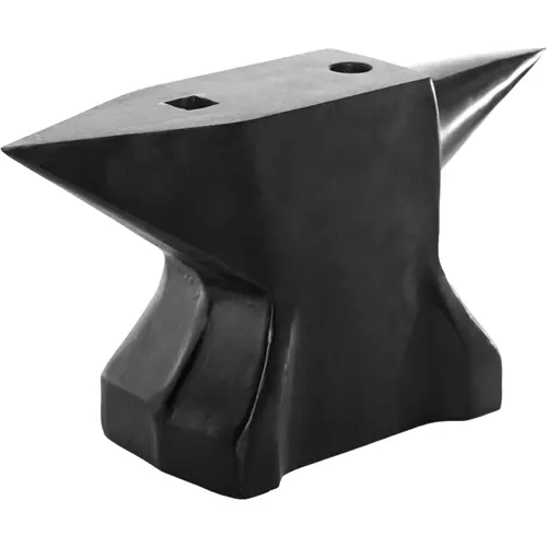

T33996 55-Pound Drop-Forged Anvil
A high-performance anvil to give greater versatility to blacksmiths, metalworkers, and artisans.
Featuring 100% drop-forged steel construction, this 55-lb. anvil provides higher hardness than softer cast iron, so you can get the most out of every hammer blow. The versatile design includes dual horn functionality, a 3/4" blind hardy hole for securing tools, and a 0.85" blind pritchel hole for punching. The hard top face is ground flat for a consistent work surface and crisp edges. Experience the outstanding mechanical qualities and static strength that outmatches any cast-iron anvil with this newly released product.
  • High Density: The extreme density of the drop-forged steel provides consistent results when working with any type of metal – achieve tight tolerances and precise dimensions.
  • High Hardness: Work more efficiently with an anvil that offers uniform face hardness of HRC 56-59 and is resistant to cracking even with intense use.
  • Two-Horned Design: This time-tested design is similar to traditional German patterns, but with a more pronounced step between the face and round horn. This gives you dual functionality for shaping and bending curves or creating precise angles.
  • Manageable Size: Stop struggling with heavy anvils – this model’s small 14-3/4" X 3-9/16" footprint and manageable 55-lb. weight make it easy to move around your shop.
  • Hardness: HRC 56–59
  • Face: 10" X 3-9/16" (80-90% ball-bearing rebound)
  • Hardy hole (blind): 3/4"
  • Pritchel hole (blind): 0.85"
  • Horn length: 4-3/4"
  • Blind mounting holes: 2 X 0.42", 4.33" C-C, 2" depth
  • Overall dimensions: 14-3/4" X 3-9/16"
  • Approximate shipping weight: 56 lbs.
