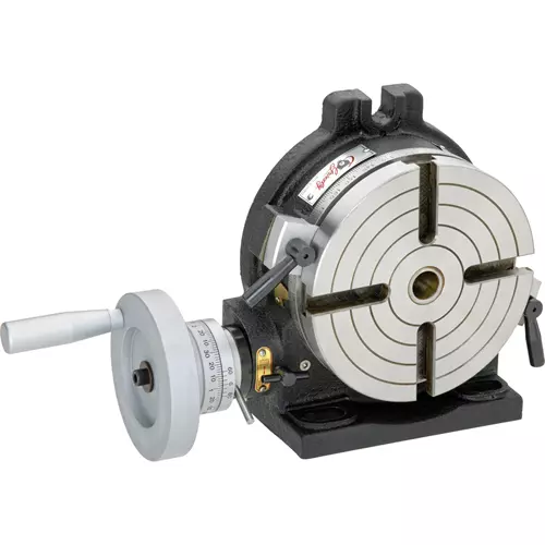

G1049 6" Combination Rotary Table
The G1049 6" Combination Rotary Table rotary table allows drilling or cutting at exact intervals around the vertical axis.
These different operations include milling eccentric features, cutting arcs, create large diameter holes, and circular profiles.
The table surface and rotating parts are ground for smooth operation. Table is a solid Meehanite casting offering stability and assured accuracy.
The rotary table moves by turning the handwheel which engages a precision worm gear. The worm gear ratio is 90:1 or 4°.
One complete turn of the handwheel moves the table 4 degrees. The micro collar is graduated in steps of 1 minute and the vernier scale can be set to indicate to 20 seconds.
Like all Grizzly rotary tables, the G1049 comes with a 1-year warranty which covers parts and assures the unit is free from factory defects.
The G1049 manual was written by our U.S. based Technical Documentation Department and is packed with useful information. The complete and easy-to-read manual makes it easier to assemble and maintain your rotary table.
The Grizzly Customer Service and Technical Support Teams are U.S. based. Parts for the rotary table may be available online and shipped from the Grizzly parts warehouse in Springfield, MO.
  • Size: 6"
  • Center Hole: MT #2
  • Slots: 4
  • Table height in horizontal position: 3-3/16"
  • Table height in vertical position: 6-7/8"
  • Approximate weight: 27 lbs.
  • Can be used vertical position
  • 4° movement per handle rotation
  • 20 second vernier scale
  • Rotary table lock
  • Free wheeling
  • Gross scale
