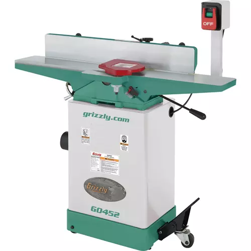

Grizzly G0452 - 6" Jointer
The latest addition to our family of jointers has some of the most remarkable features found anywhere. Starting from the ground up: built-in "kick-stand" mobile base (just push the lever down, push the machine where you want it and kick the lever back up!), built-in dust chute with 4" dust collection hood, quick adjusting lever on the infeed table, fine control handwheel on the outfeed table, positive stop at 1/8" on the infeed table, large 5" x 35" cast iron fence, rack & pinion fence adjustment, & an easy access switch with a removable safety key. CSA certified meeting CSA C22.2 #71.2-08 and UL 987-8 standards!
  • Motor: 1 HP, 120V, single-phase, 13A
  • Maximum stock width: 6"
  • Maximum depth of cut: 1/8"
  • Maximum rabbeting capacity: 1/2"
  • Cutterhead diameter: 2-1/2"
  • Number of knives: 3 HSS
  • Cutterhead speed: 4800 RPM
  • Table size: 7-1/2" x 46"
  • Table height from floor: 32-1/2"
  • Cuts per minute: 14, 400
  • Fence size: 5" H x 35" L
  • Fence adjustment: Positive stops @ 45º, 90º, & 135°
  • Overall dimensions: 46" L x 27-1/2" W x 49" H
  • Approximate shipping weight: 268 lbs.
  • Free pair of safety push blocks
