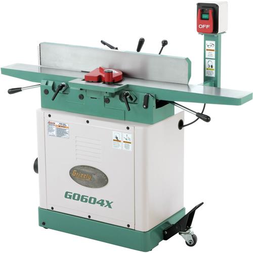

Building on the success of our larger G0490 8" parallelogram jointer, we have created a 6" model with everything you could want. The extra-long infeed table and fence makes for straighter cuts while the 1-1/2 HP motor gets the work done quickly. With the built-in adjustment of the parallelogram design, you never need to worry about your tables not being parallel. CSA certified meeting CSA C22.2 #71.2-08 and UL 987-7th standards!
SPECIFICATIONS:Motor: 1-1/2 HP, 120V/240V (prewired 120V), single-phase Amps: 15A/7.5A Precision-ground cast iron table Table size: 6" x 55-1/2" Floor to table height: 32-1/2" Maximum depth of cut: 1/8" Rabbeting capacity: 1/2" Cutterhead diameter: 3" Cutterhead: 4-knife, 6" x 5/8" x 1/8" Cutterhead speed: 4800 RPM Cuts per minute: 19,400 Power transfer: V-belt drive Switch: Push-button with large off paddle for safety Fence system: Positive stops @ ±45° & 90°& 135° Approximate shipping weight: 360 lbs.
FEATURES Parallelogram table adjustment Top-mounted switch controls Center-mounted fence 4 knife cutterhead Built-in mobile base 4" dust port Infeed and outfeed tables have lever control for convenient table height adjustments
