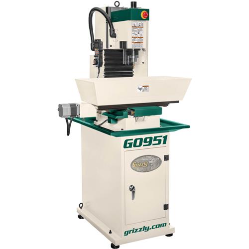

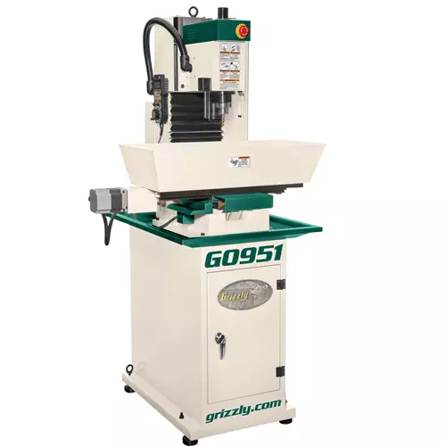

G0951 6" x 22" CNC Mill
CNC milling machine loaded with features and built to run on Mach3 software.
The G0951 6" x 22" CNC Mill is an outstanding machine with overall performance and build quality on point for a mill this size.
This machine is designed to run on Mach3 software, and comes with a Mach3 access code. Note: this software requires a dedicated PC computer or laptop, which is not included.
The lash compensator adds to the high degree of accuracy and the stepper-motor-and-ball-screw-driven power feeds on all three axes. The rapid speed for all three axes is 78 inches per minute (IPM).
Loaded with a heavy-duty R-8 spindle, the mill has variable speed from 100 to 5000 RPM.
The 6-1/4" x 21-5/8" table features three 1/2" T-slots for securing your workpieces.
The G0951 cuts quietly and smoothly, leaving a high-quality surface finish.
This will make a great addition to any shop in need of a reliable mini CNC.
Like all of the Grizzly Mills, the G0951 comes with a 1-year warranty covering parts and assuring the unit is free from factory defects. (Consumables are not covered by the warranty.)
The G0951 manual was written by our U.S.-based Technical Documentation Department and is packed with useful information. The complete and easy-to-read manual makes it easier to assemble and maintain your CNC mill.
Parts for the mill are available online and shipped from the Grizzly parts warehouse in Springfield, MO.
  • Spindle motor: 1-1/3 HP, 110V, single-phase, 6A
  • X-, Y-, Z- motors: NEMA 34, 4A
  • Spindle taper: R-8
  • Spindle speeds: Variable, 100–5000 RPM
  • Maximum distance spindle to table: 13-3/4"
  • Max distance spindle-to-column: 7-7/8"
  • Table size: 6-1/4" x 21-5/8"
  • T-slots: 3 @ 1/2" wide, 1-11/16" on center
  • Table travel (longitudinal): 11"
  • Table travel (cross): 4-5/8"
  • Head travel (vertical): 10-5/8"
  • Drilling capacity: 5/8" mild steel
  • End milling capacity: 5/8"
  • Face milling capacity: 1-1/4"
  • Footprint: 34-1/2" x 24-1/2"
  • Overall size: 30" W x 34" D x 36-1/2" H
  • Approximate shipping weight: 771 lbs.
  • Variable-speed spindle
  • Easy access to table
  • Rapid table speeds, up to 78 IPM
  • Heavy-duty R-8 spindle
  • Auto oiler for bearing rails
  • Four adjustable feet
  • 1-year limited warranty
