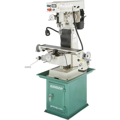

Image for Grizzly G0822 - 6" x 26" 2 HP Variable-Speed Vertical Mill with Power Feed
This Vertical Mill is a precision-made machine that is far more than just a step above a mill/drill. It features a tilting head, a knee, satin-finished dials, a stand with built-in storage cabinet, and so much more. Also features an X- and Y-axis powerfeed for smoother finishes and easy operation, as well as a variable-speed spindle control with digital PRM readout.
Made in an ISO 9001 Factory
  • Motor: 2 HP, 220V, 6.4A, 3-phase with Delta VFD that runs on single-phase
  • Spindle taper: R-8
  • Spindle travel: 3"
  • Swing: 10-1/2"
  • Max. distance spindle-to-table: 11"
  • T-Slots: 3 @ 11-1/16" centers, 1/2" wide
  • Table size: 6-1/8" x 26"
  • Table travel (longitudinal): 14-1/4"
  • Table travel (cross): 6"
  • Max. drilling capacity for cast iron: 1"
  • Max. drilling capacity for steel: 3/4"
  • Head tilt: 45° left & right
  • Ram swiveling angle: 45° left & right
  • Spindle speeds: Variable, 100-2500 RPM
  • Overall dimensions: 45" W x 68" H x 41" D
  • Approximate shipping weight: 914 lbs.
