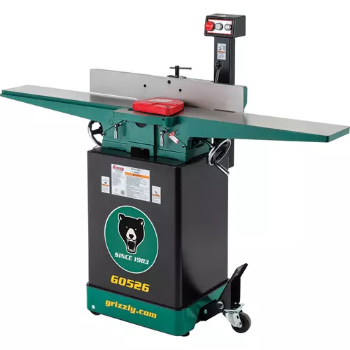

G0526 6" x 60" Jointer w/ V-Helical Cutterhead
Achieve professional results with this precision jointer that features a 60" long bed.
This is the ultimate jointer for small shops and hobbyists looking to expand their woodworking capabilities and build with confidence! With a 60" precision-ground cast-iron table you get increased support for longer workpieces – giving you flexibility to take on bigger projects.
Get absolutely pristine, tear-out free finishes with the 4-row, 6" V-helical cutterhead that includes 24 indexable carbide inserts. The shearing angle of these inserts, combined with the “V” formation of the rows, gives cleaner cuts and the smoothest, quietest operation of any cutterhead type.
This feature-packed jointer also comes with a heavy-duty precision-ground cast-iron fence and a rabbeting outfeed table; easily adjust the tables to parallel with the precision gib adjustment. For convenience, the machine includes a built-in mobile base - quickly move the jointer to wherever you need it in your shop.
This is the high-performance jointer your woodworking shop needs for consistent, smooth, accurate cuts, with the added unique touch of a custom black and green paint scheme.
FEATURES & BENEFITS:
  • 60" Table Length: Precision-ground cast-iron infeed and outfeed tables with 60" of combined total length to support tabletops, doors, and other projects.
  • V-Helical Cutterhead: Quieter operation and less tear-out than spiral and straight-knife cutterheads.
  • Precision-Ground Cast-Iron Fence: Stops at 45°, 90°, and 135° (45° outward) for quickly and accurately setting common bevels.
  • Rabbeting Outfeed Table: Allows you to cut precise rabbets using your jointer, eliminating the need for separate tool setups.
  • Precision Gib Adjustment: Gibs on dovetailed ways reduce cutterhead and table vibration and maintain table alignment.
  • Mobile Base: The cabinet stand comes with a built-in mobile base for increased portability.
  • Visual Appeal: This jointer is a visual stand-out, with an eye-catching black-on-green design combined with chromed handwheels.
  • Motor: 1-1/2 HP, 110V or 220V, single-phase, 18A/9A
  • Maximum width of cut: 6"
  • Maximum depth of cut: 1/8"
  • Maximum rabbeting depth: 1/2"
  • Minimum stock length: 8"
  • Minimum stock width: 3/4"
  • Cutterhead diameter: 2-1/2"
  • Cutterhead type: 4-row V-helical
  • Insert size, type: 15mm x 15mm x 2.5mm, indexable carbide
  • Cutterhead speed: 4800 RPM
  • Table size: 7-1/4" x 60"
  • Fence size: 29-1/4" L x 4" H
  • Dust port size: 4"
  • Overall dimensions: 60" W x 20-1/2" D x 40-1/2" H
  • Approximate shipping weight: 307 lbs.
    Elevate your woodworking – add the G0526 6" x 60" Jointer to your shop today!
