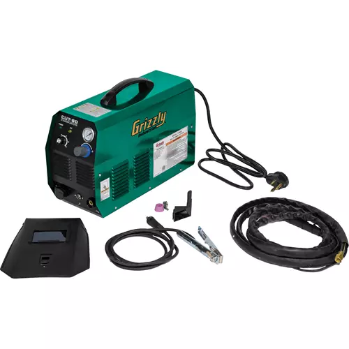

T33938 60-Amp Plasma Cutter
A high-powered plasma cutter designed for extended use in fabrication/production settings.
Looking for an efficient way to cut sheet metal, heavy-gauge steel, copper, iron, and aluminum up to 3/4" thick?
The T33938 60-Amp Plasma Cutter allows you to complete fabrication and specialty cutting tasks.
With inverter technology and a high frequency start, this 60A plasma cutter makes it easy to cut through materials with an uneven surface up to 3/4" thick. That allows you to complete unique projects without delays.
The amperage is simple to adjust with just a turn of the dial; adjust as frequently as needed during your cutting operations. Turn it up to cut through thick material. Dial it in so the sparks and dross blow out the bottom of your workpiece.
A built-in pressure regulator allows you to set the airflow to just the right level, with a gauge for constant monitoring.
Plasma cutters do have consumable components that need periodic replacing. Replacement components for the T33938 include the T33999 Electrode, T34000 60A Nozzle, T34001 Ceramic Shield, and the T34002 Replacement Cutting Torch.
  • Required power source: 220V, single-phase, min. 50A circuit
  • Output current range: 20–60A
  • Duty cycle: 60% @ 60A
  • Maximum material thickness: 3/4"
  • Air requirement: 5 CFM @ 80 PSI
  • Air fitting: NPT 1/4"
  • Torch cable length: 13'
  • Ground cable length: 8'
  • Protection class: IP21S
  • Overall dimensions: 8" W x 20-1/2" D x 14-1/2" H
  • Approximate shipping weight: 42 lbs.
  • For cutting stainless steel, copper, iron, and aluminum
  • High-frequency start
  • Adjustable amperage setting
  • Built-in pressure regulator with gauge
  • 1-year limited warranty
ACCESSORIES:
  • Two ceramic shields, nozzles, and electrodes each
  • Cutting tip
  • Brush/chipping hammer
  • Welding mask
Need help? We offer U.S.-based customer service and technical support to get your questions answered and help keep your equipment running in top condition. And to ensure your satisfaction, the T33938 comes with a 1-year warranty.
