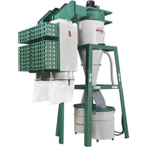

The best of the best! This is the same unit as our G0637, but pre-equipped with an upgraded dual-filtration HEPA filter system! Our dual-filtration HEPA cyclones are geared toward those looking for the best filtration on the market. Features a primary filter with efficiency of 99.9% at 0.2-2 microns and a secondary HEPA filter with efficiency of 99.97% at 0.3 microns in size. The advantage of this dual filtration setup is the majority of all fine dust is captured by the first filter and only the finest dust makes it to the HEPA filter, resulting in up to a 900% increase in the life of the HEPA filter. This results in a superbly long-lasting HEPA filter (of up to 10 years) and the ultimate in clean air quality.
We've taken our extremely successful line of Cyclone Dust Collectors a couple of steps further by adding this 7-1/2 HP monster to our selection. With dual filters, 3468 CFM of airflow capacity, and 14.7" maximum static pressure, this cyclone is ideally suited for mid- to large-sized shops with multiple dust-producing machines running at the same time. An innovative air exhaust muffler keeps the noise level down—without reducing efficiency.

- Motor: TEFC Class "F", 7-1/2 HP, 220V/440V*, 3-phase, 25A/12.5A
- Intake hole size: 10"
- Filter surface area: 261 sq. ft
- Impeller: 18" steel radial fin
- Airflow capacity: 3468 CFM @ 4.3" SP
- Maximum static pressure (inches of water): 14.7"
- Sound level: 78-80 dB
- Primary filter: 99.9% at 0.2-2 microns
- Secondary filter: HEPA rated 99.97% at 0.3 microns
- Collection drums: Steel, 55 gallon x 2
- Overall dimensions: 96-1/4" L x 52-1/2" W x 139-3/8" H
- Stand: 13 gauge steel
- Cyclone body: 16 gauge steel
- Blower housing: 11 gauge steel
- Approx. shipping weight: 1139 lbs.
