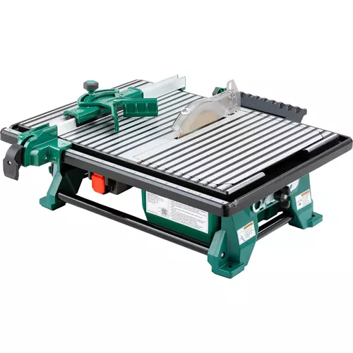

T30945 7" Benchtop Tile Saw
A wet tile saw for everyone from the professional to the DIY specialist.
An especially easy-to-learn tool for all your tile projects, the T30945 can cut tile up to 24” wide and 1-1/4” thick!
The T30945 7" Benchtop Tile Saw features an ultra-quiet 1 HP motor and smooth-sliding dual rails.
The adjustable aluminum rip fence has a locking lever to secure the cut width in place. The locking cam is adjustable for securing it to the table as well as the set screws for sliding across the table.
The 0-45° miter guide attaches to the rip fence to support workpieces at precise angles for repeatable mitered rip cuts.
The aluminum table tilts between 0–45° to provide table support of beveled cuts with built-in stops at 22.5° and 45°.
The splash hood protects you from overspray while the water return trough directs excessive water to the water bath.
The water bath has a capacity of 2.3 liters and an appropriately located drain plug.
At 28 pounds, the 7" Benchtop Tile Saw is light enough for one person to lift and move a short distance.
Like all Grizzly saws, the T30945 comes with a 1-year warranty which covers parts and assures the unit is free from factory defects. (Consumables are not covered by the warranty.)
The T30945 manual was written by our U.S. based Technical Documentation Department and is packed with useful information. The complete and easy-to-read manual makes it easier to assemble and maintain your saw.
The Grizzly Customer Service and Technical Support Teams are U.S. based. Parts for the tile saw may be available online and shipped from the Grizzly parts warehouse in Springfield, MO.
