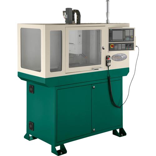

Grizzly G0875 - 7" x 24" Enclosed CNC Mill
No Reviews
$18,499.91
MSRP: $19,395.00
You Save: $895.09 (5%)
G0875 7" x 24" Enclosed CNC Mill
The G0875 7" x 24" Enclosed CNC Mill is run by Siemens® Sinumerik CNC controller and features a popular BT30 spindle with a powered pull stud tool retention system, making tool changes lightning-fast!
The positive-drive spindle, driven by a 1-1/2 HP motor, puts all the power right where you want it–directly into your tool.
Servo motors drive the ball screws on all 3 axes, providing silky-smooth, accurate power.
A 5-gallon coolant tank and dual flexible coolant nozzles ensure maximum lubrication, cooling, and cleaning during the most demanding cutting operations.
And, your shop floor stays squeaky clean thanks to the enclosure, while incorporating viewing windows to allow you to keep an eye on the cutting operation.
The G0875 manual was written by our U.S.-based Technical Documentation Department and is packed with useful information.
The complete and easy-to-read manual makes it easier to assemble and maintain your mill.
  • Spindle motor: 1-1/2 HP, 220V, single-phase, 5.1A
  • Power requirement: 220V, single-phase, 60 Hz, min. 30A circuit
  • X- motor: 0.55 HP, 220V, 3-phase, 2.1A
  • Y- motor: 1 HP, 220V, 3-phase, 2.1A
  • Z- motor: 1 HP, 220V, 3-phase, 2.1A
  • Spindle taper: BT30
  • Spindle speed: Variable, 90–3000 RPM
  • Spindle centerline to column: 8-9/16"
  • X-axis travel: 14"
  • Y-axis travel: 6"
  • Z-axis travel: 9"
  • Rapid feed rates: 240 in./min.
  • Position resolution: +-0.002"
  • Repeat position resolution: +-0.002"
  • Table size: 7" x 24-3/8"
  • Table T-slots: (3) 7/16"
  • Table weight capacity: 66 lbs.
  • Coolant tank capacity: 5 gallons
  • Overall dimensions: 65" W x 42" D x 78" H
  • Approximate shipping weight: 1444 lbs.
  • Siemens® Sinumerik CNC controller
  • Servo motors with ball screws on all axes
  • Powerful 1-1/2 HP, single-phase spindle motor
  • Variable-speed BT30 spindle
  • Easy access to table
  • Rapid table speeds of up to 240 in./min.
We offer U.S.-based customer service and technical support to get your questions answered and help keep your equipment running in top condition. And to ensure your satisfaction, the G0875 comes with a 1-year warranty.
