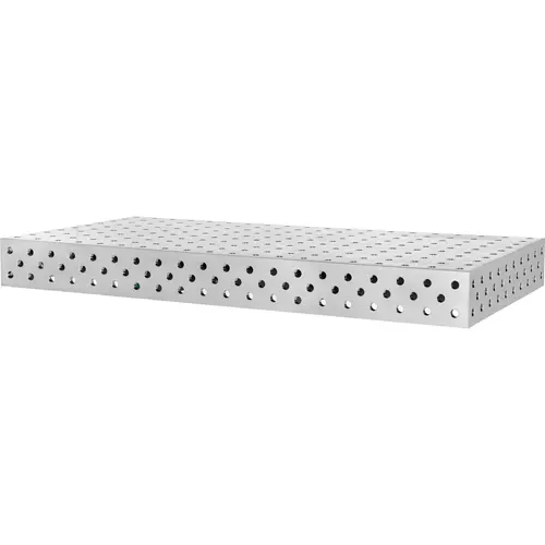

T33916 78" x 39" 3D Steel Nitride-Coated Welding Tabletop
Truly the ultimate welding tabletop on the market at this price.
The T33916 78" x 39" 3D Steel Nitride-Coated Welding Tabletop with 8" perpendicular sides, provides plenty of surface area, plus all the rigid stability you need for large welding projects.
It features 28mm diameter holes for easy setups, and built-in inch and metric scales along each edge, as well as X- and Y-axis grid lines, for making layouts.
The heavy-duty machined-steel surfaces allow for ultra-flat fixturing with a maximum weight capacity of 4400 lbs.
The specialized nitride coating protects the table from rust, deep scratches, and even splatters that occur while welding.
Please note, this item is the tabletop only. The legs are sold separately (see below for more information).
Like all Grizzly welding tables, the T33916 comes with a 1-year warranty which covers parts and assures the unit is free from factory defects.
The Grizzly Customer Service and Technical Support Teams are U.S. based. Parts and accessories for the welding table are available online and shipped from the Grizzly parts warehouse in Springfield, MO.
  • Table dimensions: 78" x 39"
  • Table thickness: 1"
  • Capacity: 4400 lbs.
  • Hole diameter: 28mm
  • Grid spacing: 10cm
  • Approximate shipping weight: 1800 lbs.
