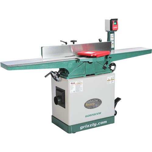

This 8" Jointer has all the features you want for precision jointing applications and ease of use. For precision jointing, we started with a six foot, cast-iron bed and added positive handwheel adjustment for both the infeed and outfeed tables. A built-in mobile base, center-mounted fence with lateral rack-and-pinion control, and a pedestal-mounted switch all combine to make this jointer one of the best you'll find anywhere.
  • Motor: 3 HP, 240V single-phase, TEFC, 3450 RPM
  • Amps: 12A
  • Precision-ground cast-iron table size: 73" x 9-3/8" x 2"
  • Number of carbide inserts: 40, 14 x 14 x 2mm
  • Cutterhead speed: 5350 RPM
  • Cutterhead diameter: 3"
  • Maximum depth of cut: 1/8"
  • Maximum rabbeting depth: 1/2"
  • Cuts per minute: 21,400
  • Fence size: 35"L x 5"H
  • Approximate shipping weight: 520 lb.
Features:
  • Beds slide on dovetailed ways
  • Shielded and lubricated bearings
  • Built-in mobile base
  • Handwheel infeed, outfeed table adjustment
  • Handwheel controlled rank-and-pinion fence adjustment
  • Built-in dust chute and 4" dust port
  • Rabbeting table
  • Easy to reach pedestal-mounted switch
