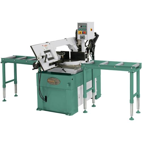

Grizzly G0664 - 8" x 13" Heavy-Duty Metal-Cutting Bandsaw with Roller Tables
Built for production, this Heavy-duty Bandsaw will cut up to 13" x 8" rectangular stock, & comes with two roller tables for supporting & feeding long, heavy material. With its built-in coolant system, swivel table, laser light cutting alignment, pedestal mounted controls, high tension blade control & adjustable hydraulic down feed control, you’ll appreciate this metal cutting machine for all your production cutting tasks.
  • Main motor 2-1/2 HP, 220V,
  • 3-phase
  • Coolant motor 1/2 HP, 220V, 3-phase
  • Blade size 131" x 1"
  • Blade speeds 160 & 320 FPM
  • Miter cutting capacity -45° to +60°
  • Cutting capacities:
  • 0°, round 11-7/8"
  • 0°, rectangular 13" x 8"
  • ±45°, round 10"
  • ±45°, rectangular 7-1/2" x 10"
  • +60°, round 7"
  • +60°, rectangular 6-1/2" x 6-1/2"
  • Floor to table height 34"
  • Overall dimensions 106"H x 74"L x 62-1/2"W
  • Approximate shipping weight 1330 lbs.
    Features:
  • Built-in coolant system
  • Centralized control panel
  • Heavy-duty all steel, one piece base
  • Adjustable hydraulic down feed & quick return to the up position
  • Two speed control
  • 45° right to 60° left swivel
  • Blade speed chart
  • Automatic shut off
  • Adjustable blade guide system
  • 25,000 lb. blade tension indicator
  • Laser light cut alignment
  • Includes 39"L x 18"W front & rear rollers
