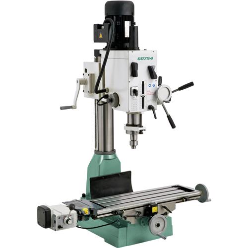

Image for Grizzly G0754 - 8" x 29" 2 HP HD Mill/Drill with Power Feed
High-precision P5 spindle bearings and dovetail ways make this Heavy-Duty Gear-head Mill/Drill a serious contender for those who need a precision machine that is also heavy-duty enough to be pushed hard when projects need to get done quickly. The 2HP, 220V, single-phase motor offers plenty of power for big cuts, and the variable-speed power feed makes it easy to dial in the perfect cutting speed for optimum results. Spindle speeds are changed using gear-head levers (instead of moving V-belts on pulleys), making it much faster and more convenient. Head positioning around the workpiece is extremely versatile—the head tilts 90° left or right, rotates 360° around the column, and has a 14-1/2" range of Z-travel movement. The spindle has 5" of downfeed travel—with both coarse and fine downfeed controls. We’ve also included a nice package of standard equipment, including spindle adapters for MT#2 or MT #3 tooling, a drill chuck with arbor, T-slot bolts and nuts, and a toolbox with service wrenches.
