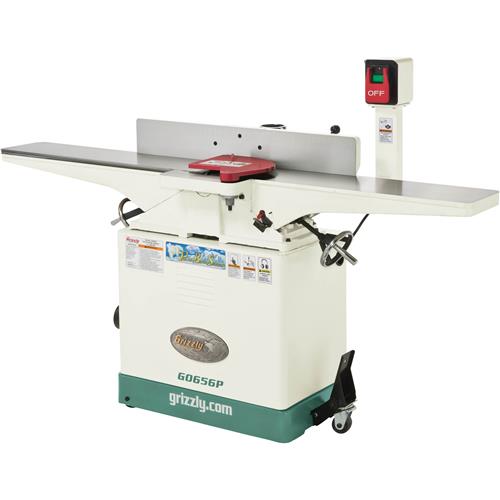

Grizzly G0656P - 8" x 72" Jointer 3 HP w/ Mobile Base, Polar Bear Series
G0656P 8" x 72" Jointer 3 HP w/ Mobile Base
This 8" Jointer has all the features you’d want for precision jointing applications and ease of use. For precision jointing, we started with a 6 foot, cast iron bed and added positive handwheel adjustment for both the infeed and outfeed tables. A built-in mobile base, center mounted fence with lateral rack and pinion control and a pedestal mounted switch all combine to make this jointer one of the best jointers you’ll find anywhere. CSA certified meeting CSA C22.2 #71.2-10 and UL 987-8 standards!
  • Motor: 3 HP, 240V, single-phase, TEFC, 3450 RPM
  • Precision-ground cast iron table size: 9" x 72-1/2"
  • Cutterhead knives: 4 HSS, 8" x 3/4" x 1/8"
  • Cutterhead speed: 4800 RPM
  • Cutterhead diameter: 3"
  • Max. depth of cut: 1/8"
  • Max. rabbeting depth: 1/2"
  • Cuts per minute: 20,000
  • Deluxe cast iron fence size: 35" L x 5" H
  • Approximate shipping weight: 500 lbs
Features:
  • Beds slide on dovetailed ways
  • Shielded & lubricated bearings
  • Built-in mobile base
  • Handwheel infeed/outfeed table adjustment
  • Heavy-duty center-mounted fence
  • Handwheel controlled rack-and-pinon fence adjustment
  • Built-in dust chute and 4" dust port
  • Rabbeting table
  • Easy-to-reach, pedestal-mounted switch controls
