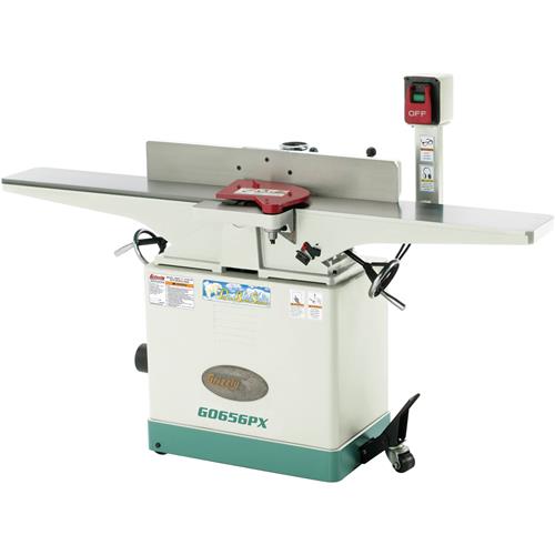

G0656PX 8" x 72" Jointer with Spiral Cutterhead
This 8" Jointer has all the features you’d want for precision jointing applications and ease of use. For precision jointing, we started with a 6 foot, cast iron bed and added positive handwheel adjustment for both the infeed and outfeed tables. A built-in mobile base, center mounted fence with lateral rack and pinion control and a pedestal mounted switch all combine to make this jointer one of the best jointers you’ll find anywhere.
CSA certified meeting CSA C22.2 #71.2-10 and UL 987-8 standards!
Note on replacement inserts:
  • For models manufactured April, 2015 and later, use H7319 replacement inserts.
  • For models manufactured March, 2015 and earlier, use T21348 replacement inserts.
  • SPECIFICATIONS:
    • Motor: 3 HP, 240V, single-phase, TEFC, 3450 RPM
    • Precision ground cast iron table size: 9" x 72-1/2"
    • Cutterhead speed: 4800 RPM
    • Cutterhead diameter: 3"
    • Max. depth of cut: 1/8"
    • Max. rabbeting depth: 1/2"
    • Cuts per minute: 21,400
    • Deluxe cast iron fence size: 35" L x 5" H
    • Approximate shipping weight: 500 lbs
    • Beds slide on dovetailed ways
    • Shielded & lubricated bearings
    • Built-in mobile base
    • Handwheel infeed/outfeed table adjustment
    • Heavy-duty center-mounted fence
    • Handwheel controlled rack-and-pinon fence adjustment
    • Built-in dust chute and 4" dust port
    • Rabbeting table
    • Easy-to-reach, pedestal-mounted switch controls
