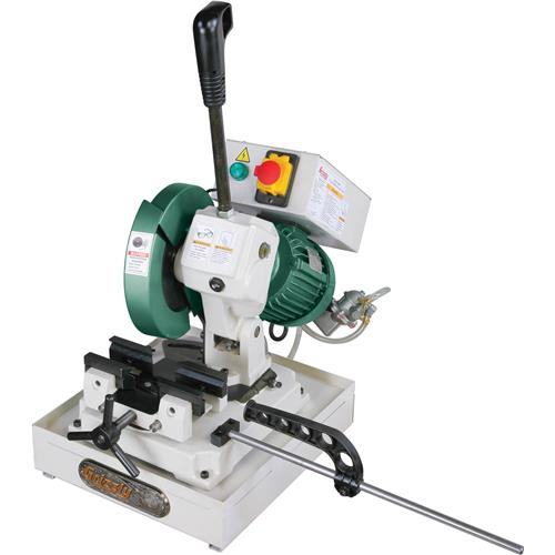

This feature packed cold saw is ideally suited to shops that cut a lot of thin walled tubing. It includes a V-notched vise that supports the workpiece on both sides of the cut, a 220 tooth blade, a coolant pump to ensure optimum blade life and finish cut and a robust gear box that transfers all of the horsepower into the blade. Use the work stop to set your length of cut, clamp in your workpiece and go!
- Motor: 1 HP, 110V, single-phase, 1725 RPM
- Blade speed: 52 RPM
- Blade size: 9"
- Arbor size: 32mm
- Max. capacity round @ 90°: 2-1/2"
- Max. capacity square @ 90°: 2-1/2"
- Max. capacity rectangular @ 90°: 3" x 2"
- Max. capacity round @ 45°: 2-1/4"
- Max. capacity square @ 45°: 2-1/4"
- Max. capacity rectangular @ 45°: 2-1/2" x 1-7/8"
- Angle cutting: 0 to 45°
- Max. vise opening: 3"
- Approximate shipping weight: 160 lbs.
