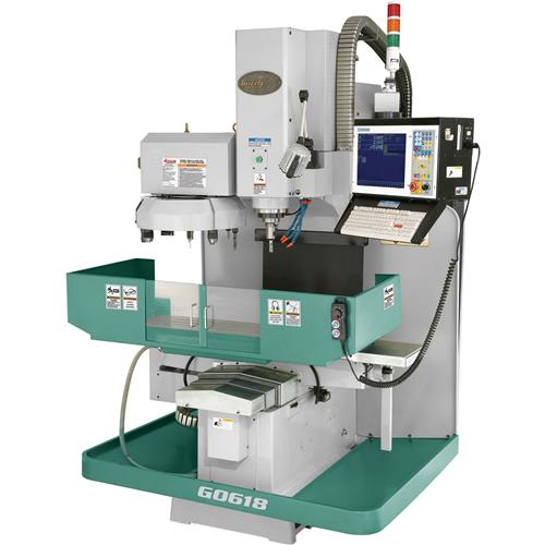

We have coupled serious muscle with the best control software on the market to bring you the power and flexibility needed in today's production environment. Our new CNC bed mill features Meehanite castings with scientifically designed webbing to enhance structural rigidity. High torque, high precision servo motors give it incredible control with 393 IPM rapids and a resolution of 0.0001" (one ten-thousandth of an inch) on 3 axis box ways. Coupled with a 12 position auto tool changer and spindle encoder allowing tool changes by code, this machine is Rigid-Tapping capable. With Centroid's® easy to use conversational programming, all of your programs can be developed right at the machine. And of course, you can up load standard G-code from your CAM software, too.
Features:
  • Centroid® M400 complete CNC controller
  • 15" LCD display with push button control functions, solid state hard drive, floppy drive, RS-232, USB and ethernet connections
  • Conversational software, cutter radius compensation, drilling cycles, multi range spindle, G-code backplot graphics, warranty, engineering and software support
  • DC310 3 axis DC servo amplifier with integrated PLC for coolant control, lube and spindle (ON/OFF), (CW/CCW)
  • 12 position auto tool changer
  • Auto lubrication
  • Spindle, table and cross feed ball screw
  • Hardened & ground base column & saddle slide way
  • C3 grade high precision ball screw for X, Y, & Z axis
  • Turcite for X, Y, & Z axis, Meehanite castings
  • Work lamp, coolant system and chip guard
  • Y axis steel slide cover
  • Roller type vertical chip guard
  • Leveling bolts and blocks
  • 3 axis feed motor
  • Tool box and tools
  • Motor: 7-1/2 HP, 220V, 3-phase, premium efficiency severe-duty induction
  • Power transfer: HTD timing belt
  • Spindle taper: CAT 40
  • Distance spindle to column: 20-1/2"
  • Min. distance spindle to table: 3-1/2"
  • Max. distance spindle to table: 25-1/2"
  • Swing: 41"
  • Table travel (longitudinal): 32-7/8"
  • Table travel (cross): 19-11/16"
  • Spindle speed: 60-8000 RPM
  • 3-axis feed: 393 IPM
  • Resolution: 0.0001"
  • Spindle movement: 22"
  • Table size: 50" x 12"
  • Table load capacity: 837 lbs.
  • Table construction: Hardened & surface ground cast iron
  • Box ways on all three axis
  • Head construction: Hardened cast iron
  • Spindle bearing: P4 class angular contact ball bearings
  • Overall height: 96"
  • Overall width: 61-1/2"
  • Overall depth: 85"
  • Footprint: 59-1/2" L x 26" W
  • Approximate shipping weight: 6506 lbs.
