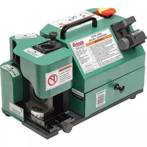

G0921 End Mill Sharpener
Keep money in your wallet by sharpening your own end mills!
This G0921 End Mill Sharpener won’t take up much room in your shop, but will deliver big results. This portable machine will grind 2-flute, 3-flute, 4-flute and 6-flute end mills, allowing you to get the most out of your tooling. No need to grow your scrap pile or send the end mills to a commercial shop for sharpening any longer.
Thanks to the simple operational design, it takes zero experience to produce amazing results. The G0921 features two grinding wheels, one for carbide bits and one for HSS bits, to help you resurface face angles from 0° to 3°.
This End Mill Sharpener comes with six ER-20 collets ranging in size from 3/16" to 9/16". All of these are contained on the collet rack within the built-in storage compartment.
  • Motor: 1/8 HP, 110V, single-phase, 1.4A
  • Collet type: ER-20
  • Collet sizes: 3/16", 1/4", 5/16", 3/8", 1/2", 9/16"
  • Grinding wheel bore size:1/2"
  • Grinding wheel maximum diameter: 3"
  • Grinding wheel maximum width: 3/8"
  • Grinding wheel type 1: SD230
  • Grinding wheel grit 1: 230
  • Grinding wheel type 2: CBM
  • Grinding wheel grit 2: 230
  • Maximum grinding wheel speed: 4400 RPM
  • Allowable end mill bit diameter: 5/32"–9/16"
  • Minimum end mill bit length: 1-3/4"
  • Adjustable face angles: 0°–3°
  • Footprint: 12" x 6-12"
  • Overall dimensions: 12" W x 7-1/2" D x 8" H
  • Approximate shipping weight: 32 lbs.
  • Sharpens 2-flute, 3-flute, 4-flute, and 6-flute end mills
  • SD230 Grinding Wheel (for Carbide Bits)
  • CBN Grinding Wheel (for HSS Bits)
  • Two ER-20 Chucks (4-sided & 6-sided)
  • Six ER-20 Collets (3/16", 1/4", 5/16", 3/8", 1/2", 9/16")
  • Storage Compartment with Collet Rack
  • 3, 4, 5, & 6mm hex wrenches
We offer U.S.-based customer service and technical support to get your questions answered and help keep your equipment running in top condition. And to ensure your satisfaction, the G0921 comes with a 1-year warranty.
