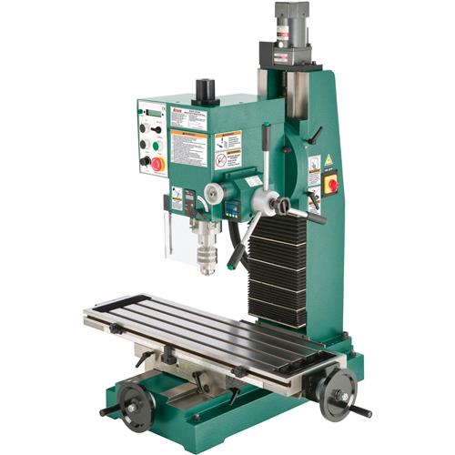

The latest addition to our family of benchtop mills has all the features you need to take on the most demanding projects. Start with the easy to use spindle speed control — just turn the dial to set your speed for optimum cuts and tool life. Tapping is also a breeze with switch control right in the handles. There are even digital displays for spindle speed, spindle height and head angle for excellent heads-up operation! And, don’t forget the powerfeed for the head — no more cranking here, just push a button to clear the tooling, change it out and push another button to drop it down to get back into the action!
  • Power head elevation
  • Digital head tilt angle display
  • Head and table travel on dovetailed ways
  • Includes 5/8" drill chuck
  • Dovetail column
  • Digital spindle scale reads metric or inches, zero set, on/off, graduated in 0.0005"
  • Head tilts 90° left, 45° right
  • Digital speed display
  • Reversing buttons on the spindle handles for tapping
  • Coolant trough
  • Front mounted fine feed knob
  • Front mounted E-stop button
  • See-through chip guard
  • Motor: 2 HP, 230V, single-phase
  • Universal Spindle taper: MT4
  • Spindle travel: 3-5/16"
  • Swing: 22-3/4"
  • Max. distance spindle to table: 16-5/8"
  • T-Slots: 4 @ 21/8" centers, 3/8" studs
  • Table size: 9-7/16" x 32-1/4"
  • Table travel (longitudinal): 16-1/8"
  • Table travel (cross): 9-5/8"
  • Headstock travel: 13-1/8"
  • Headstock tilt: 90° L, 45° R Drilling capacity: 1-1/8"
  • Quill diameter: 2.56"
  • Variable-speed: 100-1600
  • Approximate shipping weight: 641 lbs.
