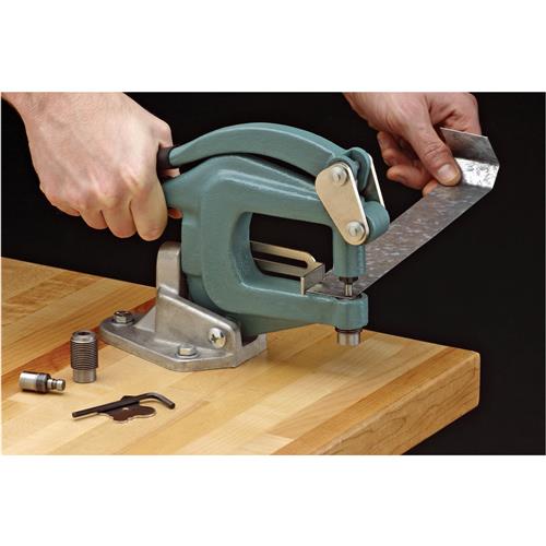

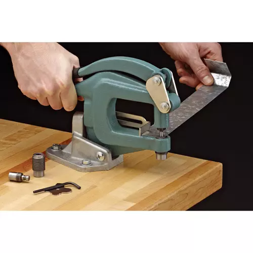

The H7862 Heavy-Duty Hand Punch with Stand punches sheet metal up to 11-gauge.
Go from stand mounted operation to hand held operation for ultimate in flexibility.
Each die has a center tip for easy hole alignment.
- Maximum pressure: 1.2 Tons
 - Jaw opening: 3/4"
 - Throat capacity: 3"
 - Punch type: Type O
- Punch sheet metal up to 11 gauge (with the 5/32" die)
 - Lever actuated handle provides plenty of force
 - Plastic carrying case included
