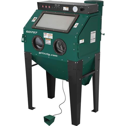

G0707 Industrial Sandblast Cabinet
Packed with features not found on other cabinets in this price range.
The G0707 Sandblast Cabinet is designed for high-use media blasting operations, where air flow up to 25 CFM and air pressure up to 120 PSI can be used.
Air pressure is fully adjustable with a control panel air pressure regulator.
A fixed blasting gun and a hand-held blasting gun are included in this machine.
The sandblasting operations through a hand-held blast gun or fixed gun are controlled by a foot valve and control panel.
An internal set of fluorescent work lamps provide illumination during blasting operations, and a built-in dust collector maintains blasting environment visibility.
The cabinet is equipped with two side loading doors for ease of workpiece loading and unloading.
Media is quickly unloaded through the hopper dump port door and reloaded through a side door.
This is going to save you time and effort on every sandblasting job!
  • Motor: 1-1/2 HP, 110V, single-phase, 11A
  • Abrasive type: Dry only
  • Working pressure: 60–80 PSI
  • Maximum air pressure: 120 PSI @ 5–28 CFM
  • Maximum abrasive capacity: 175 lbs.
  • Suggested abrasive capacity: 55 lbs.
  • Maximum load capacity: 50 lbs.
  • Dust collector filter dimensions 6-3/4" Dia. x 12" T
  • Dust collector filter type: Pleated
  • Dust collector filter rating: 5-Micron
  • Internal dimensions: 36-3/4" W x 23-3/4" D x 23"
  • Overall dimensions: 41" W x 36" D x 64-1/2" H
  • Approximate shipping weight: 286 lbs.
  • Large side load doors
  • Panel-mounted electric and air controls
  • Spare blast tips
  • Spare window protection sheets
  • Included dust collector filter
  • Screened work table
  • Foot pedal blasting control
  • Gun blasting system
  • Hands-Free blasting system
  • Hopper dump gate
  • Easy-clean dust collector
  • Reusable dust collector filter
  • Element external lighting system
