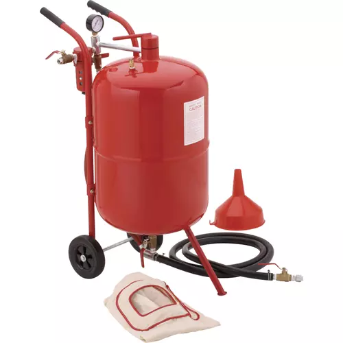

The T27158 features a pressurized tank for more sandblasting power as well as a pressure gauge and a safety pressure relief valve.
The self-emptying moisture trap makes it convenient to use.
Includes blasting hood, funnel, and four ceramic replacement tips.

  • Operating air pressure range: 65-125 PSI
  • Recommended air supply: 6-25 CFM
  • Blasting hose length: 10'
  • Tank size: 20-gallon
  • Abrasive capacity: 80 lbs.
  • Abrasive type: Dry only
  • Lighting type: 15W LED
  • Tip bore sizes: 0.065", 0.095", 0.115", and 0.135"
  • Overall dimensions: 15" W x 27-1/2" D x 35-1/2" H
  • Approximate shipping weight: 55 lbs.
