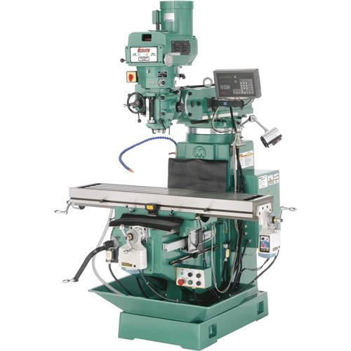

Image for Grizzly G0559 - Large Milling Machine 12 x 54
This is the colossus of knee mills! This machine is so rugged and heavy-duty that you'll have to see it to believe it. Start with a table that measures 12" X 54" X 4", that's hardened and precision ground and moves with a 3 axis power feed system. That's right, the knee has its own rapid traverse only powerfeed. And of course, the quill has its own feed rates of 0.0015", 0.003" and 0.006" with auto stop and return. Spindle speeds are easy to control with just a twist of the dial and it's variable from 90-3800 RPM. The hard chrome quill also means a lifetime of accurate, trouble free service.
Features:
  • Meehanite casting
  • One shot pump lubrication system
  • Variable-speed
  • Auto down feed
  • Auto stop with micro-adjustable setting
  • NT #40 spindle
  • Chrome plated precision ground quill
  • Y,Z covers
  • Quill feed rates: 0.0015, 0.003" and 0.006
  • Longitudinal power feed
  • Cross slide power feed
  • Knee rapid traverse
  • DRO for X and Y axis
  • 5/8" -11 TPI drawbar
  • Approximate shipping weight of 3623 lbs.
  • Motor: 5 HP, 220V, 3-phase, TEFC
  • Motor RPM: 1725
  • Power transfer: Variable belt and pulley
  • Spindle travel: 5"
  • Table travel of 28" longitudinal, 15-1/4" cross
  • Head tilt of 45 degrees both ways; head swivel of 90 degrees both ways
  • Variable-speed range: 90-3800 RPM
  • Meehanite casting
