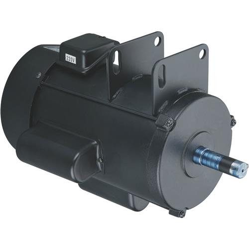

H5389 5 HP Single-Phase 3450 RPM 220V Motor For G1023ZX
A direct replacement motor for a Grizzly G1023ZX table saw.
Is your motor tired and limping on its last legs? No need to buy an entire new saw, replace the motor!
We are very pleased to offer this exceptionally high-quality motor at a discount price for the G1023ZX 10" Deluxe Heavy Duty-3 HP Table Saw.
This 3450 RPM motor has a table saw frame and is not for air compressor use.
The Totally Enclosed Fan-Cooled motor (TEFC) will keep out dust, oil, chips, or other foreign particles.
The H5389 instruction sheet was written by our U.S.-based Technical Documentation Department and is packed with useful information.
  • Power: 5 HP
  • Type: TEFC
  • Cycle: 60 Hz
  • Voltage: 220V
  • Amperage: 25A
  • Phase: Single-phase
  • Speed: 3450 RPM
  • Class: B
  • Start capacitor: 400MFD 125VAC
  • Run capacitor: 50MFD 350VAC
  • Rotation: Clockwise
  • U: 7/8"
  • N: 2.35"
  • Key: 5mm
  • C: 15.63"
  • O: 11.25"
  • TEFC capacitor-start induction
  • Clockwise rotation
  • 1-year limited warranty
Note: See second photo with motor schematic breakdown.
