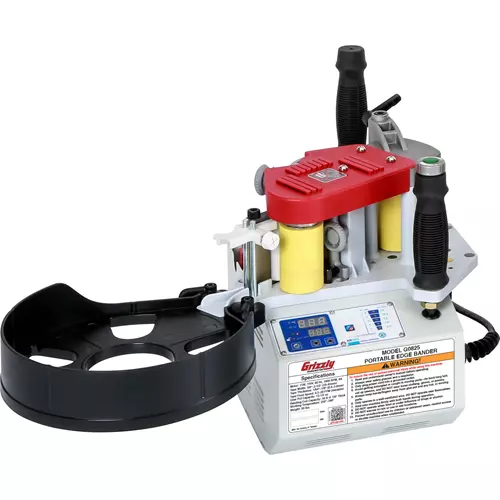

A mobile edgebander to take wherever the job site may be.
The G0825 Portable Edgebander is built to suit the needs of both professionals and hobbyists.
Easily apply edge banding from 3/8" to 2-1/2" wide along straight runs, around bends, and even the most difficult of all - inside corners!
Perfect for on-site work or integration into your woodworking shop because it combines the great features of a stationary edgebanding machine (hot melt glue application, speed feeding, and temperature control) with the convenience and portability of a handheld tool.
The feed rate control dial adjusts the edgebanding tape feed rate between 6.5 and 20 feet per minute.
The glue pot heater is designed to turn on with the press of an ON/OFF switch for safety.
Conveniently, the optional T1188 Edgedanding Trimmer Router and T1189 Dual End Cutter are specially designed for this machine to ensure perfectly aligned seams and professional-looking mitered edges on all your finished work.
Even better, mount the edgebander on the optional T1187 Table and you'll have the next best thing to a full-fledged stationary edgebander.
