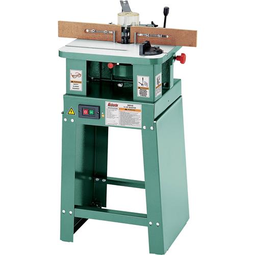

Time and again we've had customers looking to permanently mount a router in a router table for under $300. Our new 3/4 HP Shaper is the perfect solution - you get the precision of a shaper at a price that won't ruin your budget. The spindle accepts 1/2" shaper cutters. The fence assembly is easily removable and starting pins are included for freehand shaping.
Features:
  • Independently Adjustable Fence
  • Push button ON/OFF Switch
  • Includes Miter Gauge and Starting Pins
  • Precision Ground Cast Iron Table
  • Cast Iron Body Construction
  • Pre-formed Steel Stand
  • Shielded & Permanently Lubricated Spindle Bearings
  • Split Cast Iron Fence Assembly with Wood Faces for Offset Profile Shaping
  • Reversing switch
  • Motor Size: 3/4 HP, 110V, 6 AMP
  • Spindle Diameter: 1/2"
  • Spindle Length: 3"
  • Spindle Travel: 7/8"
  • Spindle Capacity Under Nut: 2-3/8"
  • Spindle Speed: 8,900 RPM
  • Table Counterbore 3" Dia. x 5/16" Deep
  • Table Size: 15-5/8" x 17-3/4"
  • Table Height: 34-1/4"
  • Overall Height (Includes Fence): 37"
  • Overall Depth: 23-1/4"
  • Overall Width: 26-1/4"
  • Shipping Weight: 195 lbs.
