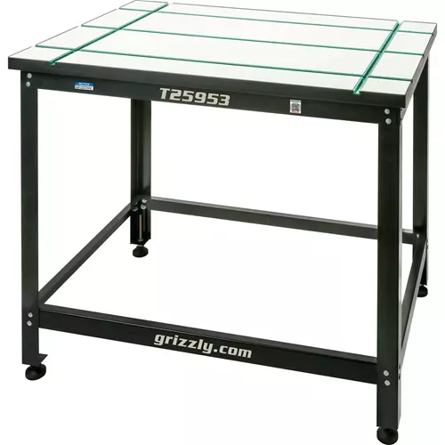

T25953 T-Slot Work Table with Stand
One of the most versatile work stations your shop can have.
The T25953 T-Slot Work Table with Stand is designed to support sanding, clamping, routing, assembly, and sawing projects.
Workpieces can be clamped virtually anywhere on the T-slot table using Grizzly's T-track auto adjust clamps and fence kits (not included).
The T-slots measure 3/4" W x 3/8" D and are compatible with 5/16" T-bolts.
The T25953 instructions were written by our U.S.-based Technical Documentation Department and is packed with useful information.
The complete and easy-to-read instructions provides full explaination on how to assemble and maintain your work table.
Like all Grizzly work tables, the T25953 comes with a one-year warranty.
Parts for the work table may be available online and shipped from the Grizzly parts warehouse in Springfield, MO.
  • Top dimensions: 40" W x 28" D
  • Steel base dimensions: 36" W x 24" D x 32" H
  • T-slot dimensions: 3/4" W x 3/8" D
  • Maximum weight capacity: 700 lbs.
  • Approximate shipping weight: 80 lbs.
  • T-slots are compatible with 5/16" T-bolts, 1/4" hex bolts, and 1/4" T-bolts
  • Anodized green extruded aluminum T-Tracks are 3/4" wide by 3/8" deep
  • 1-1/8" (30mm) melamine coated MDF with black edge banding
  • Stand includes rubber adjustable feet
  • Legs are 16-gauge, heavy-duty steel
