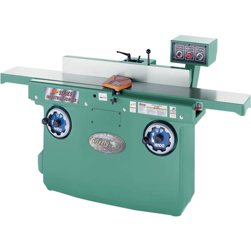

Want the very best money can buy? That's exactly how we felt when we designed the Ultimate 8" Jointer. We took all our years of experience, tossed in lots of great customer comments and produced this superior machine. It offers outstanding performance, accuracy and durability above and beyond all other 8" jointers. Just as in days long gone, we produced this machine with plenty of cast iron (over 800 lbs.) making it quiet, smooth and an absolute joy to operate. The beds are precision ground to incredible tolerances and hardened to assure decades of use. With features like smooth, precision handwheel table elevation, easy access control panel and center-mounted fence make this without a doubt, the best 8" jointer. And , it's only available from Grizzly.
  • Table measures 8-1/2" x 73-3/8"
  • 4 cam adjustment on each table provides perfect alignment
  • Height (from floor to table): 30-1/4"
  • Overall length: 73-3/8"
  • Overall width: 31"
  • Fence: 4-3/4" x 39-1/4"
  • Cutterhead diameter: 4"
  • Cutterhead knives: 3
  • Maximum depth of cut: 5/16"
  • Maximum width of cut: 7-7/8"
  • Motor: 3 H.P., 220V, single phase, TEFC capacitor start induction
  • Amps: 17
  • Cycle/RPM: 60 hertz/3450 R.P.M.
  • Switch: Magnetic with thermal overload protector
  • Power transfer: Double V-belt drive
  • Bearings: Shielded and lubricated
  • Cutterhead R.P.M.: 5,900
  • Cuts per minute: 17,700
  • Shipping weight approx. 1076 lbs.
Features:
  • Fence is center mounted, positive stops at 45° and 90°
  • Heavy-duty cast iron base
  • Independently adjustable, handwheel precision table movement with locks
  • Rabbeting capacity built-in
  • Built-in dust chute
  • Independently adjustable, precision ground cast iron table
  • 3 knife slot cutterhead with shielded ball bearings and grease fittings
  • Cast aluminum guard
Free Pair of Safety Push Blocks and Jointer Pal™ Knife Setting Jig
