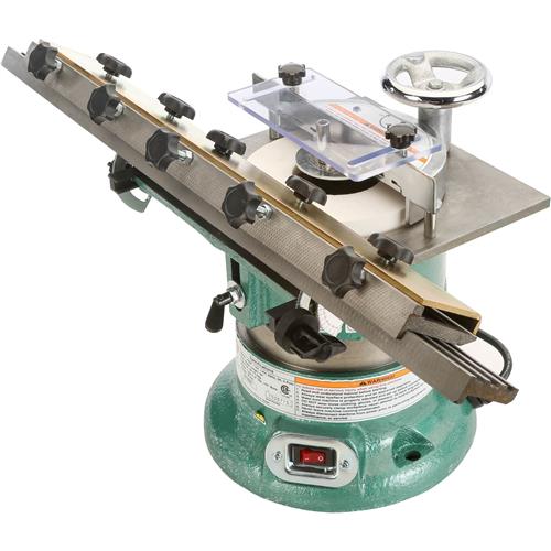

G2790 Universal Knife Grinder
Set that perfect knife edge, repeatedly.
The Grizzly G2790 Universal Knife Grinder is ideal for sharpening planer knives, jointer knives, and straight edge chisels.
The cutting tool can be positioned at angles from 15° to 90° to the grinding wheel.
The high-quality cast-iron construction, together with large capacity (will sharpen up to 20" planer blades) makes this grinder an excellent investment.
The G2790 is a dry grinder and is not designed to be used with cutting fluids.
  • Motor: 1/2 HP, 110V, single-phase,
  • Max blade length: 20"
  • Maximum knife width: 1-1/2"
  • Overall size: 24" L x 11-1/2" W x 13" H
  • Approximate shipping weight: 59 lbs.
  • Knife holder angle adjusts from 15° to 90°
  • 120-grit stone raises and lowers
  • Pre-lubricated ball bearings
  • 1/2" arbor
