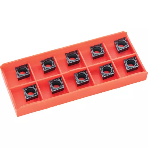

T34574 Harlingen® CCMT Carbide Inserts for Cast Iron, 10-Pk.
These CCMT 80° diamond carbide inserts are engineered for efficient turning, facing, and boring operations on cast iron. Designed with a positive geometry, they provide a clean-cutting action and offer four usable cutting edges for reliable material removal.
Each insert features a robust dual-layer defense of titanium carbonitride (TiCN) and aluminum oxide (Al2O3) coatings. This powerful combination delivers superior hardness, exceptional abrasion resistance, and excellent thermal stability, making them ideal for the challenging and abrasive characteristics of cast iron. This translates directly into increased productivity and significantly extended tool life.
These inserts provide a reliable and cost-effective solution, ensuring performance you can depend on.
  • Designation: CCMT09T304-NTM
  • Manufacturer grade: HC3215
  • Insert shape: Diamond (Rhombic)
  • Insert angle: 80°
  • Clearance angle: 7° Positive
  • Tolerance class: M
  • Insert size: 9.525mm (3/8") I.C.
  • Insert thickness: 3.18mm (1/8")
  • Nose radius: 0.4mm
  • Chipbreaker: NTM
  • Insert material: Carbide
  • Insert coating: TiCN, Al2O3
  • Target materials: Cast iron
  • Quantity: 10
Upgrade your machining operations with these CCMT09T304 carbide inserts.
