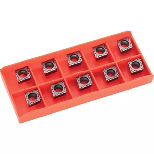

T34411 Harlingen® CCMT Carbide Inserts for Cast Iron, 10-Pk.
These CCMT 80° rhombic (diamond) carbide inserts are specifically engineered for optimal turning, facing, and boring operations on cast iron. Designed with a positive geometry and an exceptionally sharp cutting edge, they provide clean, precise cuts and offer two usable cutting edges for reliable material removal. They are compatible with standard tool holders designed for positive diamond inserts.
Each insert is enhanced with titanium carbonitride (TiCN) and aluminum oxide (Al2O3) ceramic coatings. These advanced, multi-layer coatings significantly boost overall hardness and provide exceptional abrasion and heat resistance, translating directly to increased productivity and a longer tool lifespan for your operations.
These inserts provide a reliable and cost-effective solution, ensuring performance you can depend on.
  • Designation: CCMT060204-NTM
  • Manufacturer grade: HC3210
  • Insert shape: Diamond (Rhombic)
  • Insert angle: 80°
  • Clearance angle: 7° Positive
  • Tolerance class: M
  • Insert size: 6.35mm (1/4") I.C.
  • Insert thickness: 2.38mm (3/32")
  • Nose radius: 0.4mm
  • Chipbreaker: NTM
  • Insert material: Carbide
  • Insert coating: TiCN, Al2O3
  • Target materials: Cast iron
  • Quantity: 10
Upgrade your machining operations with these CCMT060204 carbide inserts.
