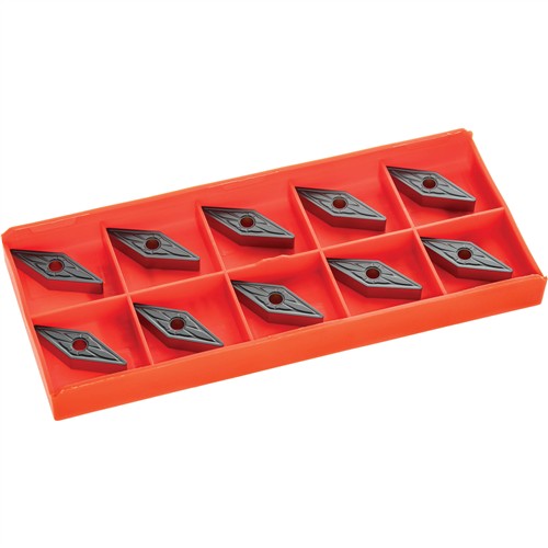

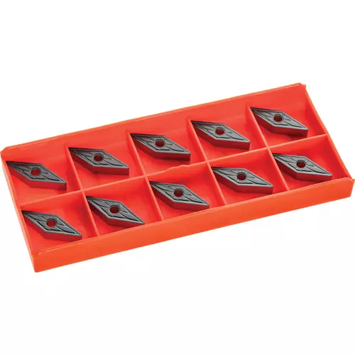

T34436 Harlingen® VNMG Carbide Inserts for Cast Iron, 10-Pk.
These VNMG 35° diamond carbide inserts are specifically engineered for turning and facing operations on cast iron, delivering exceptional performance in demanding applications. Their strong, negative geometry makes them highly durable and provides four usable cutting edges per insert (two on each side), maximizing tool life and efficiency.
Each insert features an advanced dual-layer defense of titanium carbonitride (TiCN) and aluminum oxide (Al2O3) ceramic coatings. This powerful combination delivers superior hardness, alongside exceptional abrasion and heat resistance. That translates directly into increased productivity and a significantly extended tool life, particularly when machining the abrasive and heat-intensive material that is cast iron.
These inserts provide a reliable and cost-effective solution, ensuring performance you can depend on.
FITS:
  • H8291 Lathe Tool Holders
  • H8292 Lathe Tool Holders
  • H8293 Lathe Tool Holders
  • H8294 Lathe Tool Holders
  • H8295 Lathe Tool Holders
  • H8296 Lathe Tool Holders
  • H8297 Lathe Tool Holders
  • H8298 Lathe Tool Holders
  • H8299 Lathe Tool Holders
  • Designation: VNMG160408-NKR
  • Manufacturer grade: HC3210
  • Insert shape: Diamond (Rhombic)
  • Insert angle: 35°
  • Clearance angle: 0° Negative
  • Tolerance class: M
  • Insert size: 9.525mm (3/8") I.C.
  • Insert thickness: 4.76mm (3/16")
  • Nose radius: 0.8mm
  • Chipbreaker: NKR
  • Insert material: Carbide
  • Insert coating: TiCN, Al2O3
  • Target materials: Cast iron
  • Quantity: 10
Upgrade your machining operations with these VNMG160408 carbide inserts.
