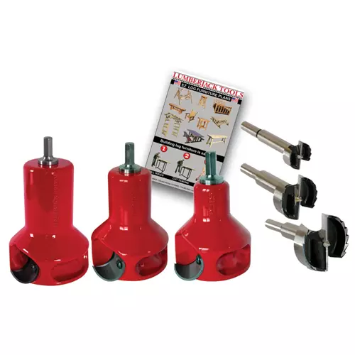

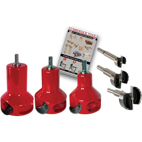

The 1", 1-1/2", & 2" Home Series Master Kit is a complete all purpose - build anything package that gives you small, medium and large tenon joint cutting capabilities. With this medium-duty kit, you can build beds, railings, coffee and end tables, chairs, benches and anything you can dream… Used by homeowners, hobbyists and occasion users, you can cut structural, semi and non structural joints for your indoor and outdoor projects.
KIT INCLUDES:
  • 1" Home Series Tenon Cutter
  • 1-1/2" Home Series Tenon Cutter
  • 2" Home Series Tenon Cutter
  • 1" Forster Drill Bit
  • 1-1/2" Forster Drill Bit
  • 2" Forster Drill Bit
  • 10 Piece EZ Plan Booklet
TENON CUTTER FEATURES:
  • Dual Blade Cutting Technology
  • Durable, Powder Coated Finish
  • Die Cast A380 Aluminum Body
  • Hardened, Precision Ground High Carbon Tool Steel Blades
  • Blades can be Resharpened or Replaced
  • Threaded - Replaceable Shank
TENON CUTTER SPECIFICATIONS:
TRH1000 - 1" Tenon Cutter
  • Tenon Diameter = 1"
  • Maximum Tenon Length = Up to 2-1/2"
  • Maximum Log Diameter = Up to 2-1/2"
  • Radius Shoulder Profile
  • Drill Type: Single Speed 1/2" drill - less than 750 RPMs
  • Weight = 2 lb.
  • Diameter = 3.250"
  • Length = 4.875"
TRH1500 - 1-1/2" Tenon Cutter
  • Tenon Diameter = 1-1/2"
  • Maximum tenon length = Up to 3-1/2"
  • Maximum Log Diameter = Up to 3"
  • Drill Type: Single Speed 1/2" drill - less than 550 RPMs
  • Weight = 2.50 lb.
  • Diameter = 3.750"
  • Length = 5.875"
TRH2000 - 2" Tenon Cutter
  • Tenon Diameter = 2"
  • Maximum tenon length = Up to 4-1/2"
  • Maximum Log Diameter = Up to 3-1/2"
  • Weight = 3.0 lb.
  • Diameter = 4.250"
  • Length = 6.875"
FORSTNER DRILL BITS:
  • Type = Brad Point - Saw Tooth
  • Hole Diameter = 1"
  • Hole Diameter = 1-1/2"
  • Hole Diameter = 2"
  • Shank Size = 3/8"
