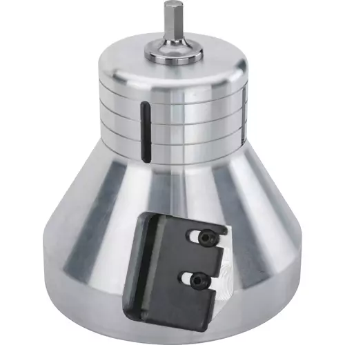

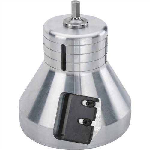

Image for Lumberjack Tools T24600 - 3" 60 Degree Tenon Cutter
$332.08 Price: $332.08
MSRP: $415.00 Original Price: $415.00
You Save: $82.92 (20%) Savings: $82.92
Our largest structural size tenon cutter is the 3" size. This large cutter is typically used on gates, fences and bed or hand rails with oversized logs. This commercial-duty, continuous rated large joint cutter is perfect for making structural joints on indoor and outdoor projects. Designed for ranchers or hobby farmers, professional contractors, homebuilders, craftsmen. Made in the USA.
  • Dual Blade Cutting Technology
  • Precision, CNC Machined
  • Billet, T651 - 6061 Aircraft Grade Aluminum
  • Hardened, Precision Ground High Carbon Tool Steel Blades
  • Blades can be Resharpened or Replaced
  • Threaded - Replaceable Shank
  • In-Sight Measurement System
    • measure & see tenon during cutting operation
  • Quick Stop Tenon System
    • allows user to place a "dead stop" internal to the tool for quick, accurate repetitive cutting
  • Lifetime Guarantee
  • Tenon Diameter =3"
  • Maximum Tenon Length = Up to 3-1/2"
  • Maximum Log Diameter = Up to 5-1/2"
  • Drill Requirements: MILWAUKEE Hole Hawg / Right Angle Drill - Single Speed 1/2" or 3/4" drill - less than 450 RPMs
  • 60 Degree Shoulder Profile
  • Weight = 6 lb.
  • Diameter = 6.450"
  • Length = 7.625"
