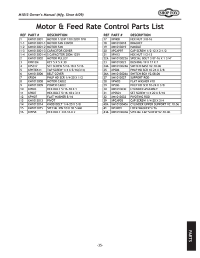

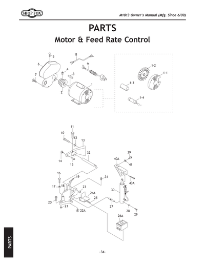

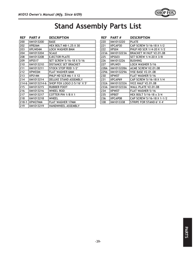

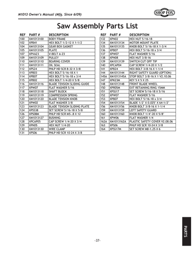

PXM1013001
*DISCD*MOTOR 1/2HP 110V/220V 1-PH
P
MOTOR FAN COVER
$21.35
P
MOTOR FAN
$12.80
PXM1013001-3
CAPACITOR COVER
PXM1013001-4
Now: PC200
S CAPACITOR 200M 125V 1-5/16 X 2-1/4
PXM1013002
MOTOR PULLEY
PXM1013003
Now: PK12M
KEY 5 X 5 X 30
PXM1013004
Now: PSS17
SET SCREW 5/16-18 X 5/16
PXM1013005
TAP SCREW #8 X 3/4
PXM1013005-1
Now: PW06
FLAT WASHER 1/4
PXM1013006
COMPLETE PULLEY COVER ASSY
PXM1013007
Now: PB19
HEX BOLT 1/4-20 X 1/2
PXM1013008
MOTOR CABLE
PXM1013009
POWER CABLE
PXM1013010
Now: PB03
HEX BOLT 5/16-18 X 1
PXM1013011
Now: PB07
HEX BOLT 5/16-18 X 3/4
PXM1013012
Now: PW07
FLAT WASHER 5/16
PXM1013013
PIVOT
PXM1013014
MALE KNOB
PXM1013015
POSITION PIN
PXM1013016
Now: PB58
HEX BOLT 3/8-16 X 2
PXM1013017
Now: PN08
HEX NUT 3/8-16
P
BRACKET
$118.95
PXM1013019
HANDLE 3/8-16
PXM1013020
CAP SCREW 1/2-12 X 2-1/2
PXM1013021
Now: PN13
HEX NUT 1/2-13
PXM1013022
Now: PCB19
CARRIAGE BOLT 3/8-16 X 1-3/4
PXM1013022A
Now: PCB19
PXM1013023
BUSHING
P
SWITCH BASE V1.03.05
$8.65
PXM1013024A
SWITCH BASE
PXM1013025
Now: PS06
PHLP HD SCR 10-24 X 3/8
P
SWITCH BOX V1.03.05
$51.95
PXM1013026A
TWO-BUTTON SWITCH W/SWITCH BOX
P
SWITCH BOX ASSY V3.11.14
$120.20
P
ON/OFF BUTTON SWITCH KEDU KJD12 120V
$58.40
PXM1013027
SUPPORT ROD
PXM1013028
Now: PW03
FLAT WASHER #10
PXM1013029
Now: PS06
PXM1013030
CYLINDER ASSY V2.06.06
PXM1013031
Now: PSS04
SET SCREW 1/4-20 X 5/16
PXM1013032
PIVOTING ROD
P
ADJUSTMENT LUG
$10.90
P
SCREW ROD
$7.90
P
COMPRESSION SPRING
$5.45
PXM1013036
BALANCING BRACKET
PXM1013037
Now: PLW04
LOCK WASHER 3/8
PXM1013038
Now: PB18
HEX BOLT 3/8-16 X 1
PXM1013039
CAP SCREW 1/4-20 X 3/4
P
CYLINDER UPPER SUPPORT V1.03.05
$27.90
PXM1013040A
PXM1013041
Now: PLW01
LOCK WASHER 5/16
P
UPPER SUPPORT PIN 1/4-20 X 1/2 V1
$4.85
PXM1013043A
Now: PSS26
SET SCREW 10-24 X 3/8
PXM1013045
Now: ps23
PHLP HD SCR 8-32 X 1/4
P
STRAIN RELIEF PG11 TYPE-3
$5.95
P
SWITCH CORD 18GA 3W 24"
$19.60

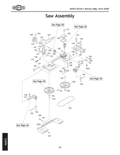

PXM1013100
BODY FRAME
P
WORM GEAR SHAFT
$23.55
PXM1013102
Now: PB41
HEX BOLT 1/2-12 X 1-1/2
PXM1013104
GEAR BOX GASKET
PXM1013105
COVER
PXM1013107
V-BELT AX23, COGGED
PXM1013108
Now: PB32
HEX BOLT 5/16-18 X 5/8
PXM1013109
WORM GEAR PULLEY
PXM1013110
BEARING COVER
PXM1013111
OIL SEAL TC15 X 35 X 7
PXM1013112
Now: PS24
PHLP HD SCR 8-32 X 3/8
PXM1013113
Now: PB03
PXM1013114
Now: PB07
PXM1013115
Now: PB02
HEX BOLT 1/4-20 X 5/8
PXM1013116
BLADE TENSION SLIDING GUIDE
PXM1013117
Now: PW07
FLAT WASHER 5/16
PXM1013118
SHAFT BLOCK
PXM1013119
SPRING 75 X 2 X 10
PXM1013120
BLADE TENSION ADJUSTABLE KNOB
PXM1013121
Now: PW02
FLAT WASHER 3/8
PXM1013123
BLADE TENSION SLIDING PLATE
P
BLADE TENSION LABEL
$3.05
PXM1013124
Now: PSS38
SET SCREW 5/16-18 X 5/8
PXM1013126
Now: PS08M
PHLP HD SCR M5-.8 X 12
PXM1013127
BUSHING 19 X 17 X 7
PXM1013128
PXM1013129
Now: PN05
HEX NUT 1/4-20
P
WIRE CLAMP
$1.60
PXM1013131
Now: PS06
PXM1013132
Now: PN02
HEX NUT 5/16-18
PXM1013134
MOTOR MOUNT PLATE
PXM1013135
PLUM SCREW 5/16 X 18 X 45
PXM1013136
Now: PB07
PXM1013137
Now: PW07
FLAT WASHER 5/16
PXM1013138
Now: PN08
HEX NUT 3/8-16
PXM1013139
SWITCH CUT OFF TIP
PXM1013140
CAP SCREW 1/4-20 X 1/2
PXM1013141
Now: PB24
HEX BOLT 3/8-16 X 1-1/4
PXM1013144
SAFETY GUARD RIGHT
PXM1013145
Now: PB18
HEX BOLT 3/8-16 X 1
P
STOP BOLT 3/8-16 X 1 V2.10.06
$1.60
PXM1013147
Now: PK23M
KEY 5 X 5 X 25
PXM1013148
BLADE WHEEL FRONT
PXM1013150
Now: PR05M
EXT RETAINING RING 15MM
PXM1013151
Now: PSS17
PXM1013152
Now: PW07
FLAT WASHER 5/16
PXM1013153
Now: PB07
P
BLADE 1/2" X 0.025" X 64-1/2"
$47.00
PXM1013156
LOCK KNOB 3/8-16 X 31
PXM1013159
SAFETY GUARD LEFT
PXM1013160
KNOB BOLT 1/4 -20 X 5/8
PXM1013161
Now: PW06
FLAT WASHER 1/4
P
BLADE BACK SAFETY COVER V1.03.05
$33.60
PXM1013162A
BLADE BACK SAFETY COVER V2.11.06
PXM1013163
Now: PS06
PXM1013164
SET SCREW M8-1.25 X 6
P
BASE
$174.15
PXM1013202
Now: PB26M
HEX BOLT M8-1.25 X 30
PXM1013203
LOCK WASHER 8MM
PXM1013204
SCALE
P
SCREW PLATE
$6.95
P
HANDLE AND SHAFT
$25.35
P
RUBBER SLEEVE
$3.45
PXM1013208
PROTECT PLATE
PXM1013209
Now: PSS17
PXM1013210
DISTANCE SET BRACKET
PXM1013211
STOCK STOP ROD 1/2 X 216
PXM1013212
Now: PW01M
FLAT WASHER 8MM
PXM1013213
Now: PB03M
HEX BOLT M8-1.25 X 16
P
DELUXE STAND ASSEMBLY
$215.45
P
*DISCD*STRIPE TAPE
$4.35
PXM1013214-6
Now: D3375
Shop Fox Nameplate - Small
PXM1013215
RUBBER HD SCR 3/8 X 30
PXM1013216
WHEEL ROD 19" TO 20" V1.04.03
P
COTTER PIN 1/8 X 1 V1
$1.60
P
COTTER PIN 2.5 X 25 V2.12.16
$3.55
PXM1013218
STAND WHEEL
PXM1013218-1
FLAT WASHER 17MM
P
HANDWHEEL ASSEMBLY
$21.45
PXM1013219-1
HANDWHEEL ASSEMBLY
PXM1013219-2
HANDWHEEL ASSEMBLY
P
PLATE
$5.80
PXM1013221
CAP SCREW 5/16-18 X 1/2
PXM1013222
Now: PS04
PHLP HD SCR 1/4-20 X 1/2
PXM1013223A
BRACKET W/NUT V2.01.08
P
ACME NUT V1.07.04
$23.90
P
ACME NUT V2.08.06
$21.70
PXM1013225
Now: PSS03
SET SCREW 1/4-20 X 3/8
PXM1013226
BUSHING
PXM1013227
Now: PLW01
LOCK WASHER 5/16
PXM1013228A
ACME SCREW V2.01.08
PXM1013229A
VISE BASE V2.01.08
PXM1013230
Now: PW07
FLAT WASHER 5/16
PXM1013231
CAP SCREW 5/16-18 X 1/4
PXM1013232A
VISE JAW BRACKET-FRONT V2.01.08
PXM1013233A
VISE JAW BRACKET-REAR V2.01.08
PXM1013234
Now: PW07
FLAT WASHER 5/16
PXM1013235
Now: PB07
PXM1013236
CAP SCREW 5/16-18 X 1-1/2

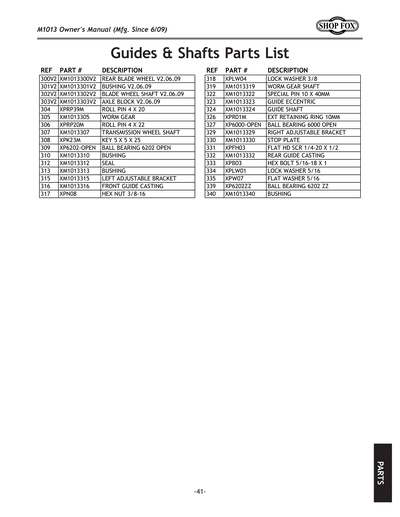

PXM1013300
BLADE WHEEL W/BUSHING V1.04.03
PXM1013300V2
PXM1013301
BUSHING
PXM1013301V2
BUSHING
PXM1013302
ASSY DRAWING W/ BLADE WHEEL SHAFT
PXM1013302A
PXM1013302V2
PXM1013303
PXM1013303A
PXM1013303V2
PXM1013304
PXM1013305
WORM GEAR
PXM1013306
ROLL PIN 4 X 22
PXM1013307
TRANSMISSION WHEEL SHAFT
PXM1013308
Now: PK23M
KEY 5 X 5 X 25
PXM1013309
BALL BEARING 6202-OPEN
PXM1013310
BUSHING
PXM1013312
PXM1013313
BEARING BUSHING
PXM1013315
ADJUSTABLE BRACKET LEFT
PXM1013316
BLADE ADJUSTMENT FRONT
PXM1013317
Now: PN08
HEX NUT 3/8-16
PXM1013318
Now: PLW04
LOCK WASHER 3/8
PXM1013319
WORM GEAR SHAFT
PXM1013322
BEARING PIN
PXM1013323
GUIDE PIVOT RIGHT
PXM1013324
BEARING SHAFT
PXM1013326
Now: PR01M
EXT RETAINING RING 10MM
PXM1013327
BALL BEARING 6000-OPEN
PXM1013329
ADJUSTABLE BRACKET RIGHT
PXM1013330
***USE P0561267-1***
PXM1013331
Now: PFH03
FLAT HD SCR 1/4-20 X 1/2
PXM1013332
BLADE ADJUSTABLE REAR
PXM1013333
Now: PB03
PXM1013334
Now: PLW01
LOCK WASHER 5/16
PXM1013335
Now: PW07
FLAT WASHER 5/16
P
CARTON FOR M1013
$19.80
P
STYROFOAM
$35.95
P
STRIPE FOR STAND 6" X 4'
$1.60
PXM1013339
BALL BEARING 6202ZZ
PXM1013340
BUSHING
P
MACHINE ID LABEL
$16.40
P
SAFETY GLASSES LABEL
$1.60
P
DISCONNECT POWER LABEL
$1.60
P
AMPUTATION HAZARD LABEL
$1.60
PXM1013404
GLOSSY BLACK
PXM1013405
ELECTRICITY 1.4W X 1.2H
PXM1013406
SHOP FOX WHITE M1006
PXM1013407
BLADE TENSION LABEL
PXM1013408
P
MANUAL FOR M1013 08/06
