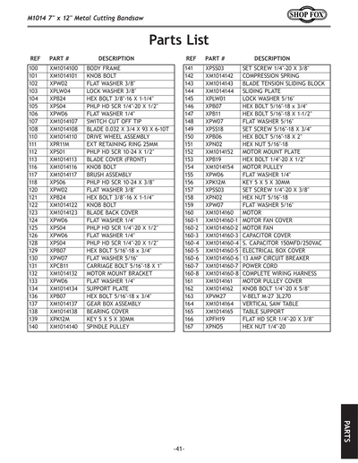

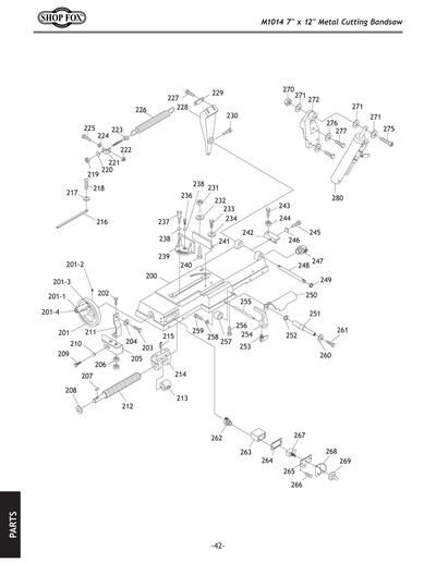

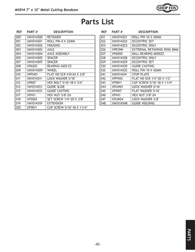

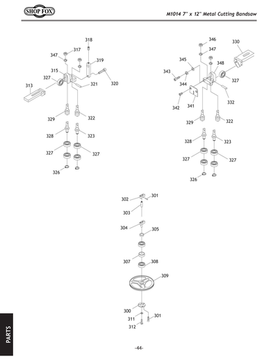

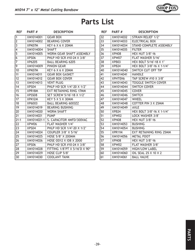

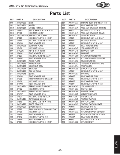

Parts for M1014 7" x 12" 1 HP Metal-Cutting Bandsaw
Parts Diagrams for M1014 - 7" x 12" 1 HP Metal-Cutting Bandsaw
Parts List for Parts for M1014 7" x 12" 1 HP Metal-Cutting Bandsaw
