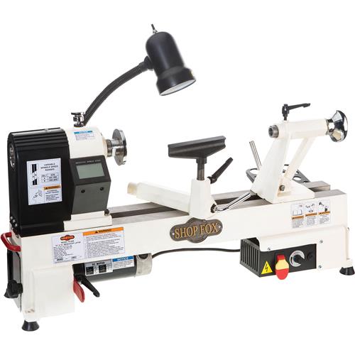

W1836 12" x 15" Benchtop Wood Lathe
A lathe packed with features that woodturners love.
The Shop Fox W1836 12" x 15" Benchtop Wood Lathe has a powerful 3/4 HP motor with electronic variable-speed spindle control and a digital RPM readout for precise speed adjustments to make this lathe a top choice.
24 indexes in increments of 15° allow evenly spaced cuts while the headstock stays in a locked position, which opens new possibilities not available on most benchtop lathes.
The heavy-duty cast-iron construction combined with rubber feet allow for increased stability and smooth turning operations.
Like all Shop Fox benchtop machines, the W1836 comes with a 2-year warranty which covers parts and assures the unit is free from factory defects. (Consumables are not covered by the warranty.)
The W1836 manual was written by our U.S.-based Technical Documentation Department and is packed with useful information. The complete and easy-to-read manual makes it easier to assemble and maintain your lathe.
The Shop Fox Customer Service and Technical Support Teams are also U.S.-based. Parts for the lathe may be available online and shipped from the parts warehouse in Springfield, MO.
  • Motor: 3/4 HP, 110V, single-phase, 7.4A
  • Swing over bed: 12"
  • Swing over tool rest base (banjo): 9"
  • Distance between centers: 15"
  • Spindle speed range: 5000 - 3800 RPM
  • Spindle threads: 1" x 8 TPI
  • Spindle taper: MT#2
  • Tailstock taper: MT#2
  • Tool rest width: 6"
  • Tool rest post diameter: 16mm
  • Footprint: 8" x 31-1/2"
  • Overall dimensions: 38-1/2" W x 15-1/2" D x 17" H
  • Approximate shipping weight: 85 lbs.
  • Electronic variable-speed spindle control
  • Digital RPM readout
  • Low speed spindle range of 500-1800 RPM
  • High speed spindle range of 1000-3800 RPM
  • Spindle indexing in 15-degree increments
  • Spindle lock pin
  • Tool holder
  • Work lamp
  • Safety paddle switch with removable key
  • Heavy-duty cast-iron bed
  • Non-skid rubber feet
  • Included tool holder, knockout bar, live center, spur center and 3" faceplate
