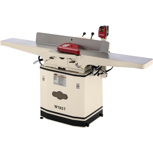

Shop Fox W1857 8" x 72" Dovetail Jointer with Mobile Base
Step up from a benchtop to a larger capacity 8" jointer.
The W1857 Jointer with Mobile base is a feature packed machine with so much to offer.
The 9" x 72" precision-ground cast-iron table is ready to surface plane, edge joint, bevel joint, and square stock.
The tables are easily adjusted by heavy-duty cast-iron handwheels and move along dovetail ways.
The easy-to-use fence has built-in stops to simplify adjustments between 45°, 90°, and 135°.
Also, you'll get 25% more cuts per minute with the 4-knife cutterhead, which leaves a smoother finish and requires less sanding than the typical 3-knife models.
The single-sided knives are made of high-speed steel (HSS). HSS has been heat treated for hardness and wear resistance, which keeps a sharp edge longer than other carbon steels.
Additional features include a thermal protection switch, built-in mobile base, and integrated 4" dust port.

  • Motor: 3HP, 230V, single phase, 12A
  • Maximum width of cut: 8"
  • Maximum depth of cut: 1/8"
  • Maximum rabbeting depth: 1/2"
  • Minimum stock length: 10"
  • Cutterhead diameter: 3-1/16"
  • Cutterhead type: 4-knife
  • Knife size, type: 8" x 3/4" x 1/8", HSS single-sided
  • Cutterhead speed: 5500 RPM
  • Total table size: 9" x 72"
  • Fence size: 4-5/8" x 38"
  • Fence system: positive stops
  • Overall dimensions: 72-1/2" W x 25-1/2" D x 42" H
  • Approximate shipping weight: 488 lbs.
  • Two-year warranty!!
  • Super long 6' table
  • Center mounted fence
  • Built-in mobile base with internally-mounted, non-directional casters
  • 4" dust port
  • Rabbeting table
  • Powder coated finish
